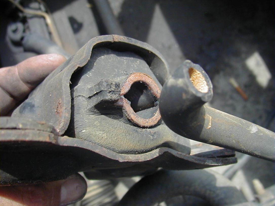

The 94 I spotted in the U-Pull-It yard yesterday had the engine and trans removed so I could see the mounts. I unbolted both figuring that I'd give them a try since new ones aren't available from GM.
After looking at them closely I decided to pass. The rubber inner part kind of rattles around inside the steel shell and the bottom of the rubber is compressed and bulging out the end. I doubt they'd be any better than the ones I have in my car now.
