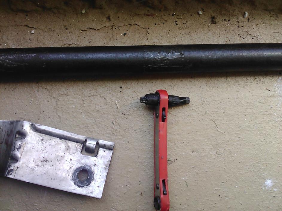

Here is the wrench i created to remove that bracket.
