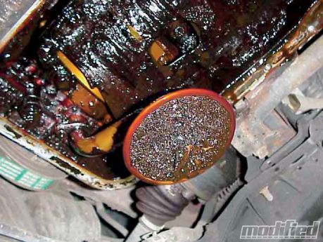

link is to build up on bearing, picture is build up around the bearing. if its this bad replace engine.
http://underthehood.mahleclevite.com...ingsludge2.jpg

I have put crank kits in Dozens of engines but also as mechanic you get to see what most of the guys in the shop are doing. I have never seen a motor sludged up that bad. I seriously doubt that motor was getting any oil to the valves. I still stand by my earlier post. Cleaning that craps out of the motor is still better then leaving it in. Higher oil pressure is nice, higher oil pressure by choking off the flow of oil to other parts of the motor is the fastest way to scrap a motor.
