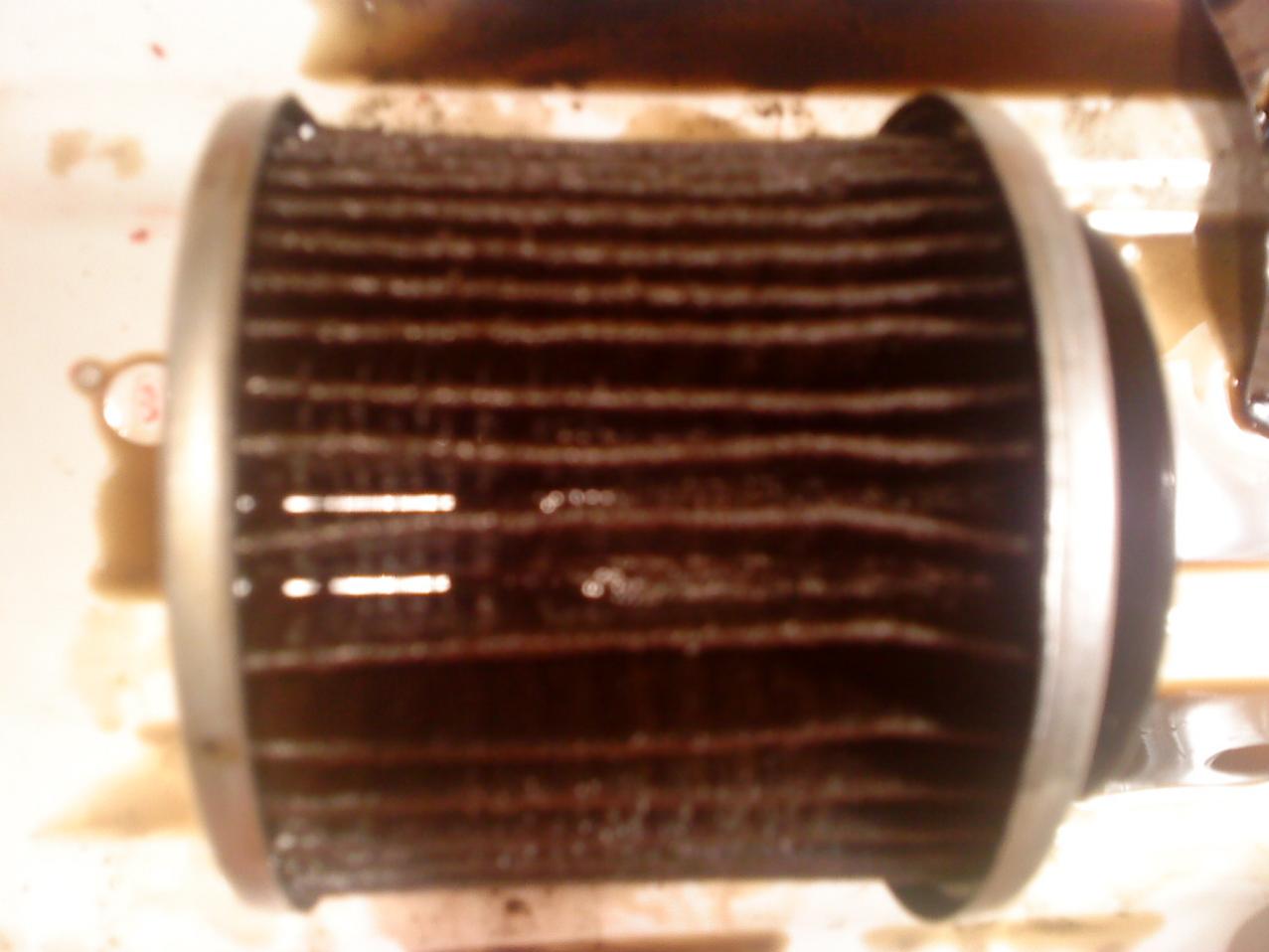

Its not as bad as the first filter I open. But I sure the metal top with the drain back should be seal/stuck to the filter, but it wasnt.

if those pleats were scrunched in like that without your help it was plugged bad. I've seen fuel filters do that but never a oil filter. did you spread the pleats, nasty stuff is usually stuck way in the corner part.
Those pleats were like that when I opened it. I used a hacksaw with out crushing it. I thought the spring in the oil filter caused that over time. Not much stuff was in it. the oil and filter dont got much on it less then 100 miles. but i live in florida so it does take the heat.
I put a hose in the threaded hole and sucked the oil through the filter so it wouldn't be a mess when I opened it and it came through.
