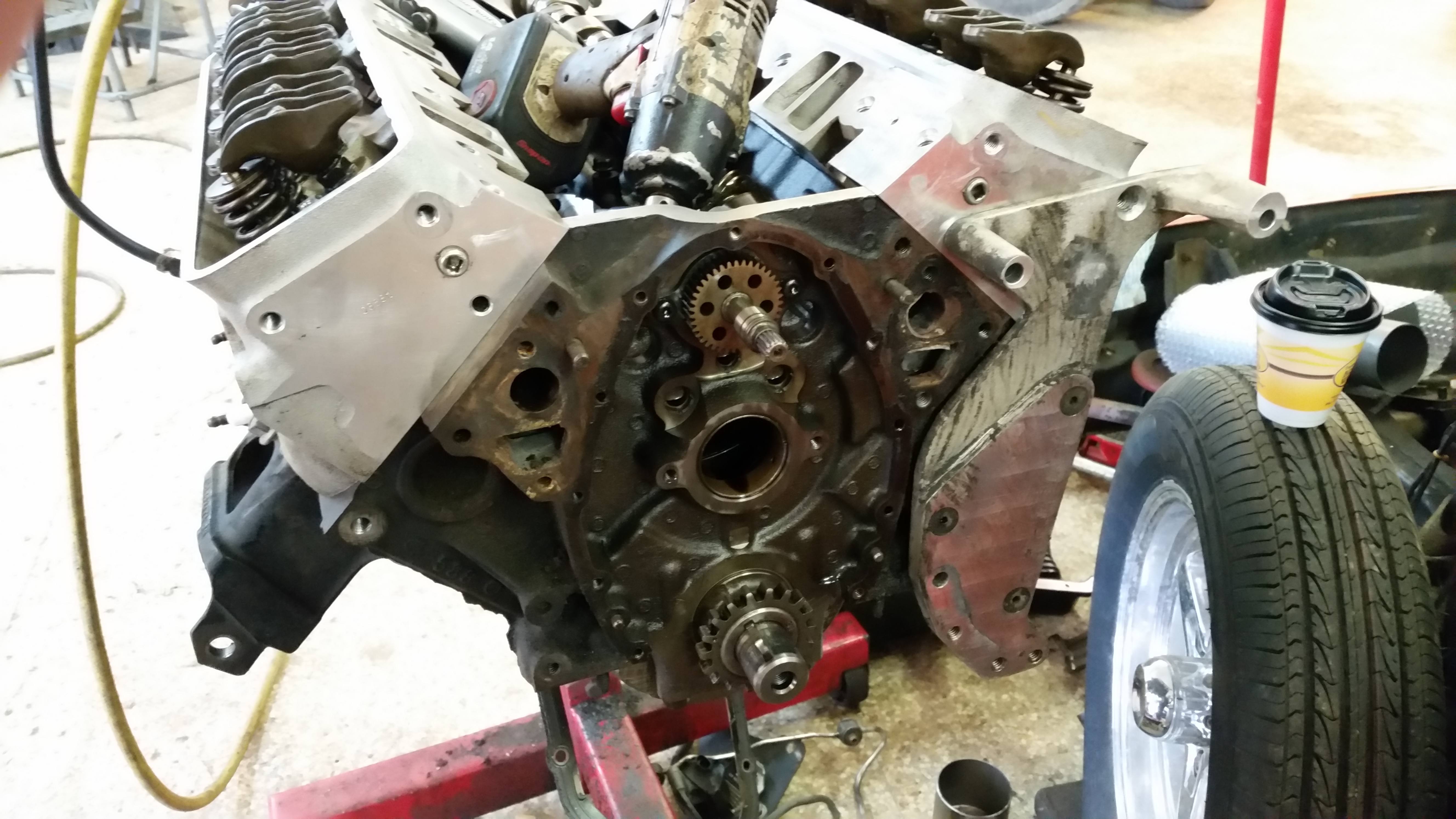

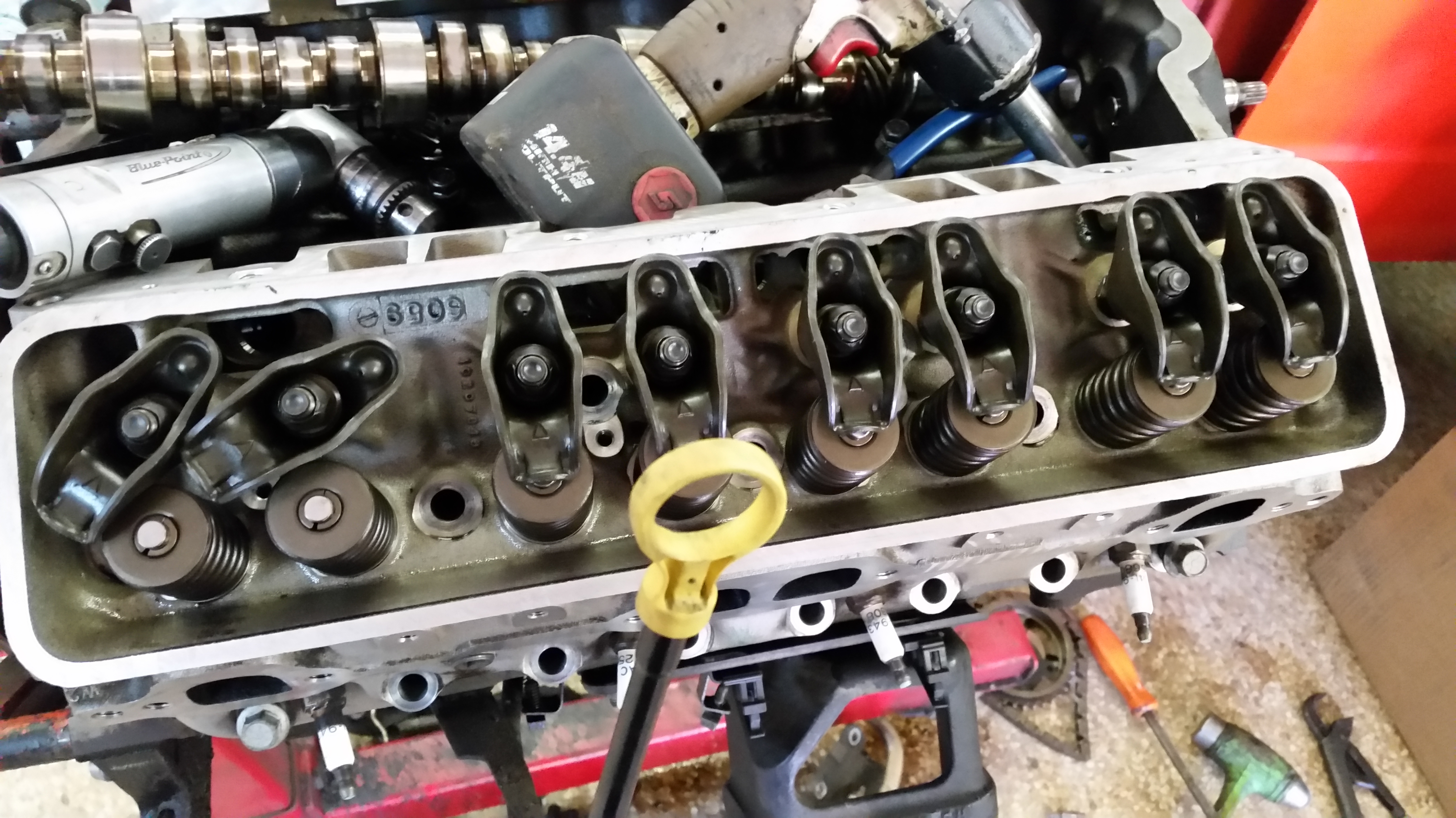

MOVING THIS FROM THE NEWBIE BOARD. I've had my Z for several months now and I have been very impressed with how easy this car is car is to drive on the street. I drive it every chance I get. It will hold it's own in a drag race. I am still on street tires and traction is an issue. I bought a new set of 17x9.5 wheels and some MT Street SS tires. I was having trouble hitting 3rd gear with the factory Hurst shifter so I got the Hawks Sinister precision shifter. I blew out a head gasket so I took the opportunity to pull the engine and replace all the gaskets and take a look at the internals to see exactly what I have. This engine is completely stock. That is very surprising considering how strong it runs. Everything looked brand new so I didn't change anything except to add a bolt in Comp Cams bump stick for supercharger applications, 218/230 495/510 114. Interesting not on the camshaft. Summit, JEGS and Comp Cams does not have a SC grind cam for a stock engine. Comp Cams told me if I gave them the specs that they could make a custom grind for me. I started Googling more and found Hawks Motorsports had the one I ended up purchasing. Kind of weird that Hawks has this (and another more radical) in stock but Comp Cams does not. I also got a Grant 4 spoke steering wheel just for looks. All of the parts are not on the car yet but will be very soon. Really excited to see what difference the cam and drag radials make.

Just curious, but why would you put a cam meant to be used for a boosted application, in a N/A car? Unless you plan on adding later on. But if you plan staying N/A, there is a wide selection of better cams.
The reason no on else makes a boosted cam grind for stock engine is because most engines that utilize boost are not stock. They are forged, lower compression, with all other bolt ons, and heads matched to the application.

It has a Powerdyne 11A on it. There was another thread on the newbie board where I discussed some of the things going on with what was, at the time, a new car to me. There are some gaps here because of 2 threads.
Sorry for the confusion.
