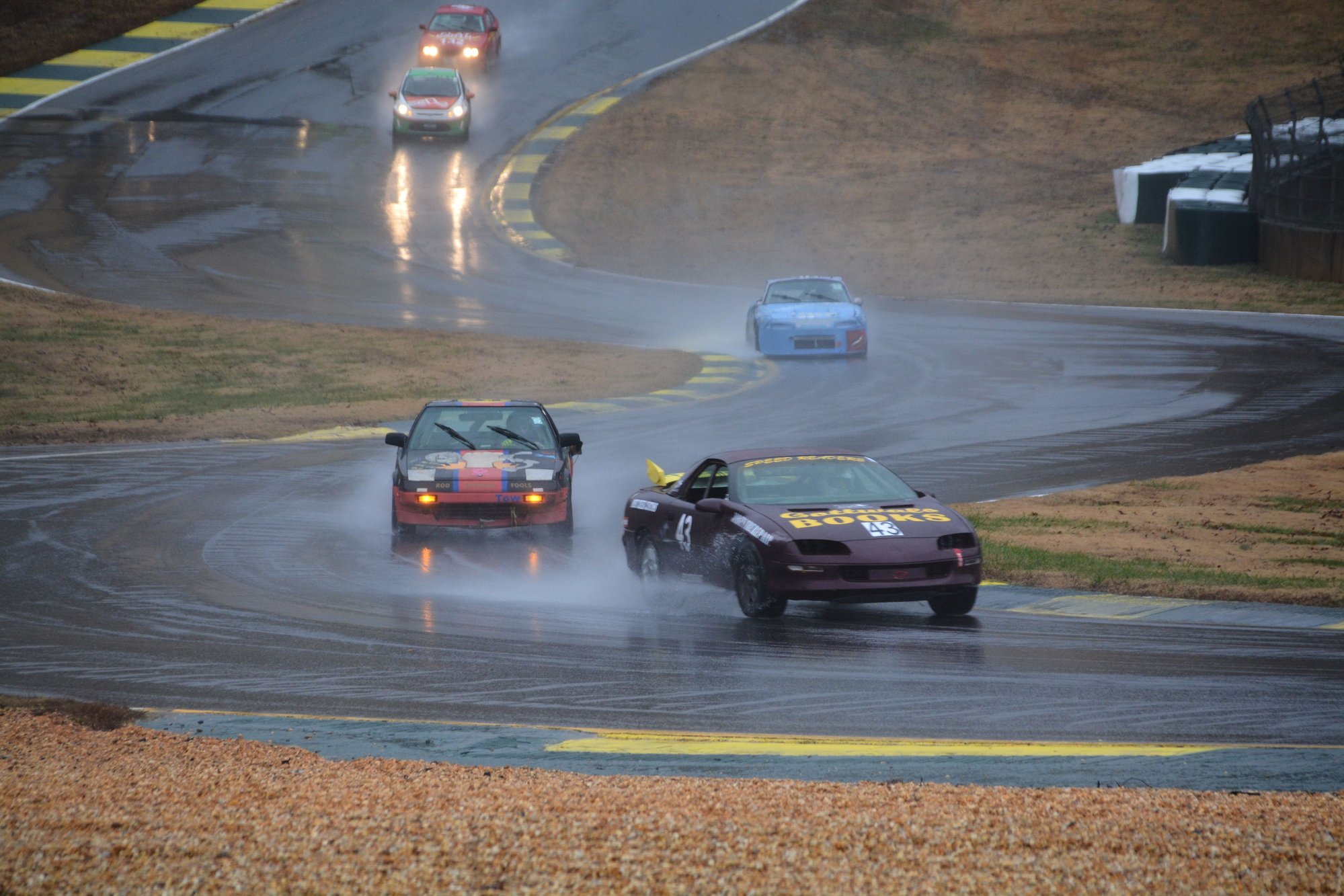

For those curious, here's a picture of it running in the race!
