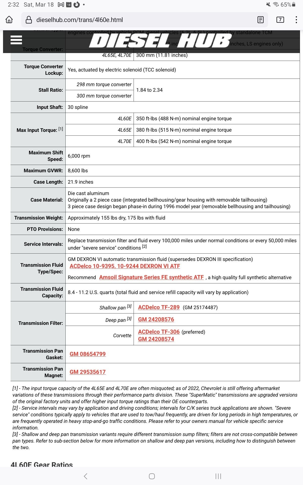

As I was double checking whether or not to use Synthetic ATF when I do the filter change, I found this site with great info and specs on the 4L60E transmission.
https://www.dieselhub.com/trans/4l60e.html
