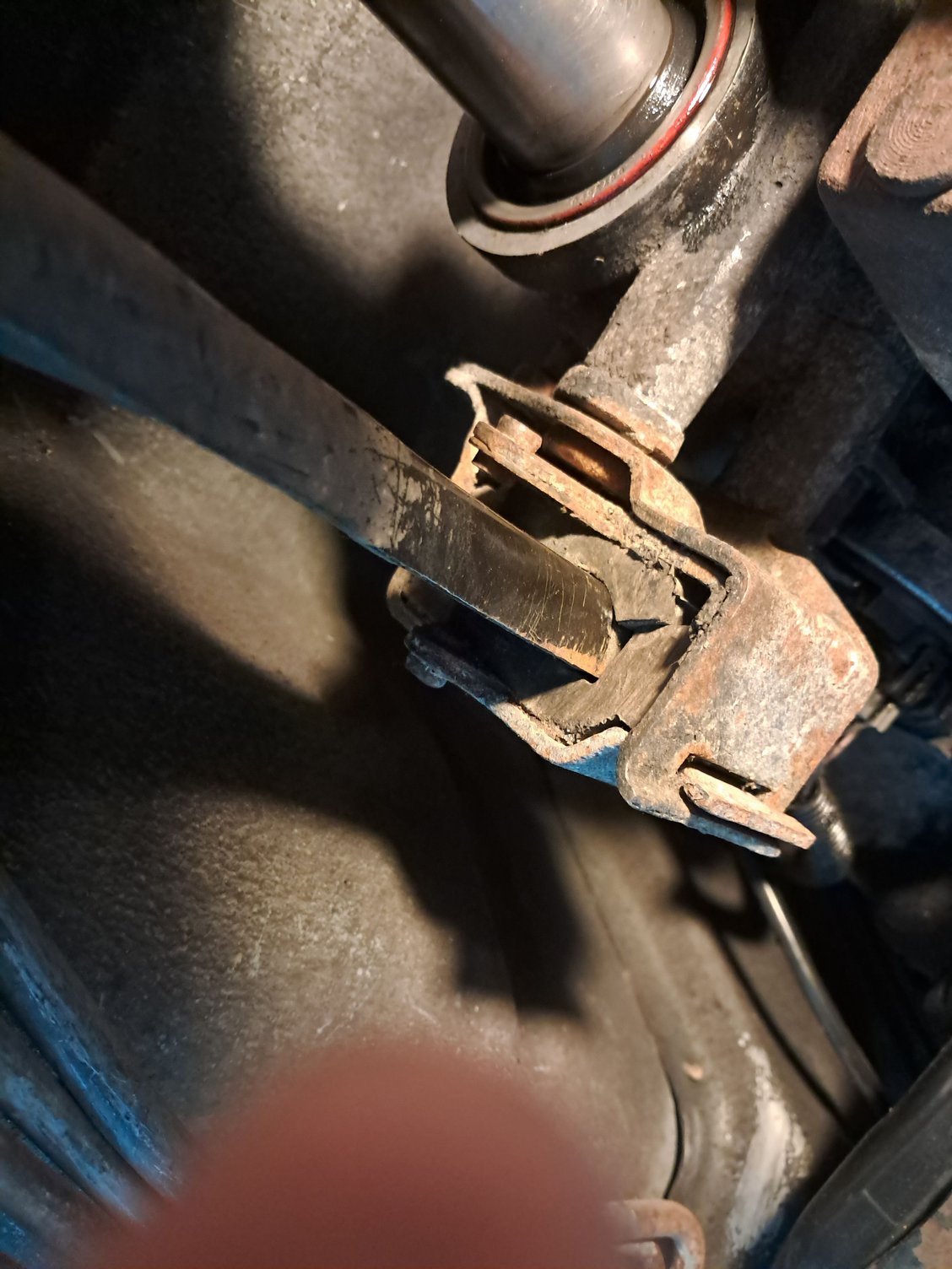

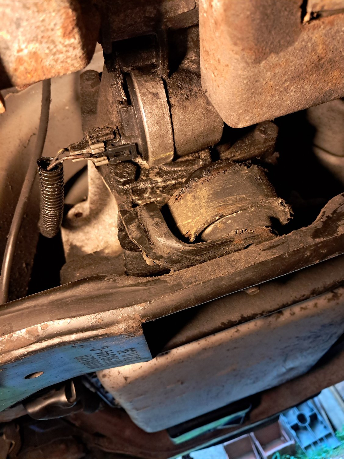

I'm 99% sure it's the mounts/bushings. Even though this thing was idle for 13+ years, it does have 127,000+ miles, the original trans mount, and torque arm inner bracket bushing from 1995. When I was under the car on my back doing the ds they both "looked" and felt ok with no super obvious disintegration but I didn't really try and torque on them with a pry bar or whatever to see how much real play there might be. Honestly, I wasn't thinking about any other solution at the time but my "new" one-piece aluminum ds and ujoints. The clunk and jerk was so profound that I wasn't even thinking bad bushings could be the problem. I'll hop under there today and do a more comprehensive assessment.

No doubt its both bushings. Took some pics and a vid but even an 11 second vid was 24 megs on lower res setting. I'm pretty sure 2" of vertical play between tranny and support is out of acceptable limits . The problems reported by a bunch of folks with the poly replacement for the tranny is still weighing a bit on my mind. Surely, at least 2 or 3 experts here have used them?
