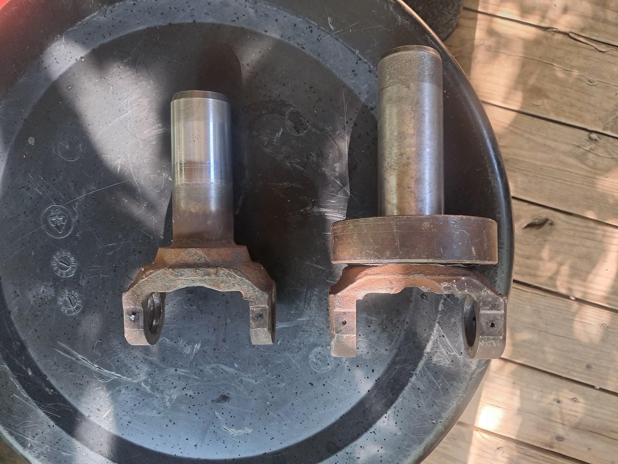

Front joint developed a vibration and a clank so I yanked it cleaned it up purty-like and stuck a pair of Spicer 5-795X on it that I got fir $30 apiece. I noticed that the slip yoke that came with the SS (aluminum) shaft is a bit longer and beefier with that giant weight attached to it. My smaller yoke also has a thinner fork where the caps are mounted.
1) The xtra length is nominal and of no consequence but what is up with the giant counterweight on the SS yoke?
2) If you look, there's a very visible rubber seal around the inner part of the weight/disc. Torching the ujoints off with a propane torch took a bit longer to melt than acetylene would have and the whole knuckle got very toasty so I don't know what/if there will be a potential issue with that seal sooner or later.
3) I like the fact that my smaller, original, slip yoke that came off my two-piece is way lighter though. Is there an advantage to the beefier yoke?
4) Also, found some noise in a forum somewhere about a (2 opposing metal composition's) chemical reaction between the ujoint's steel cap reacting with the aluminum slip yokes fork?? Any validity to this actually causing an issue b4 I'm dead & gone?
5) Thoughts?
TIA

Posts: 22,022
must be for harmonics did a search for aluminum driveshaft 2000 Camaro and best I could tell they had that on them as well.
https://www.bing.com/images/search?q...hacc=0&first=1

RE: the dampener/counterweight/harmonic "balancer?" on the slip yoke, I just pounded it off and polished the yoke up nicely.
