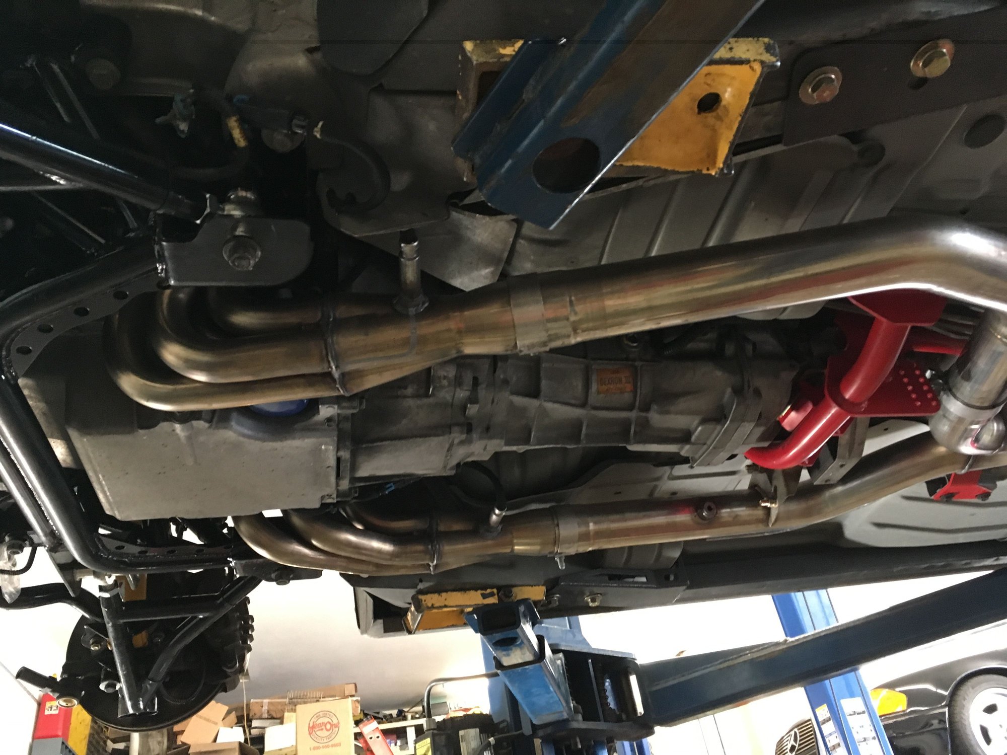

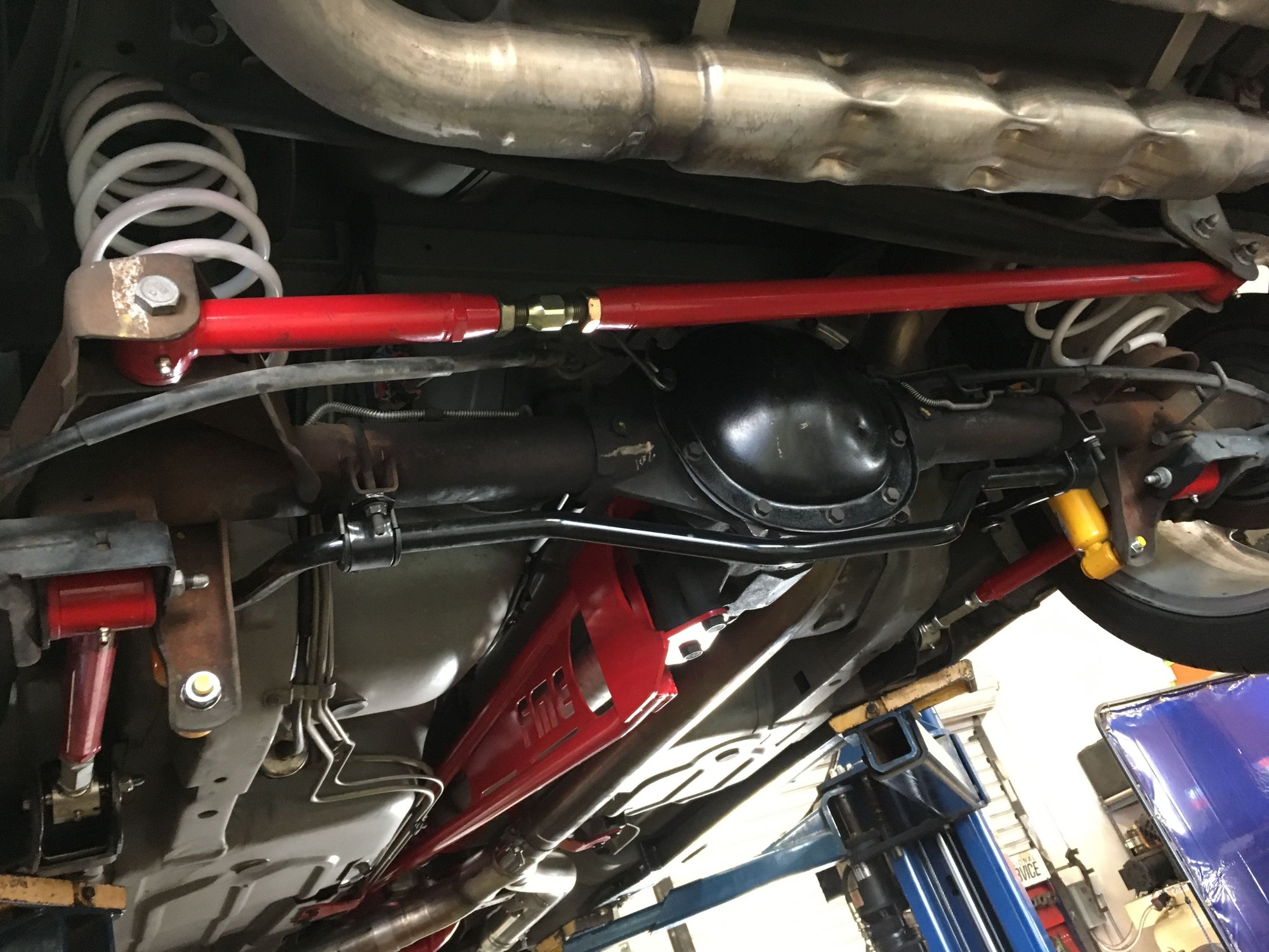

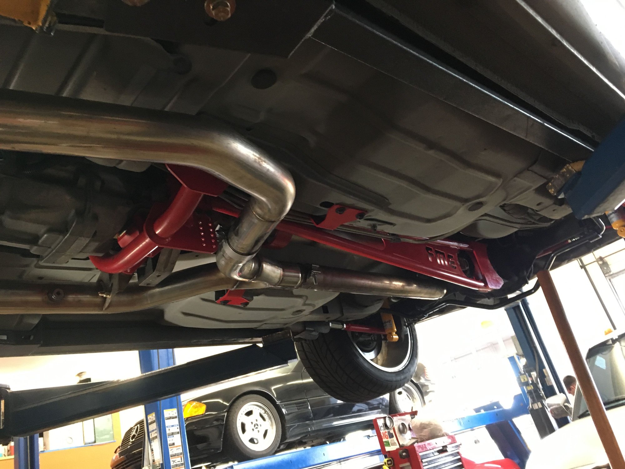

Originally Posted by cheetoh
I wish! God is that clean underneath.
Your car will be fine with stock parts since it's a stock V6 cruiser.
Mine is putting down some power,everything under it is race suspension K-member on back.
Subframe connectors Strano lowering springs and sway bars,Koni shocks etc.
I went with poly mounts since it's a six speed stick and gets run hard,it has an LS7 clutch on a RAM aluminum flywheel so when I let her rip it's taking a pounding.
It's not a good daily driver,big cam highway gears not town friendly, but it's a blast to drive on the back roads out in the country where I live.
She's in the garage most of the time,never driven in the rain just a sunny day weekend fun car.

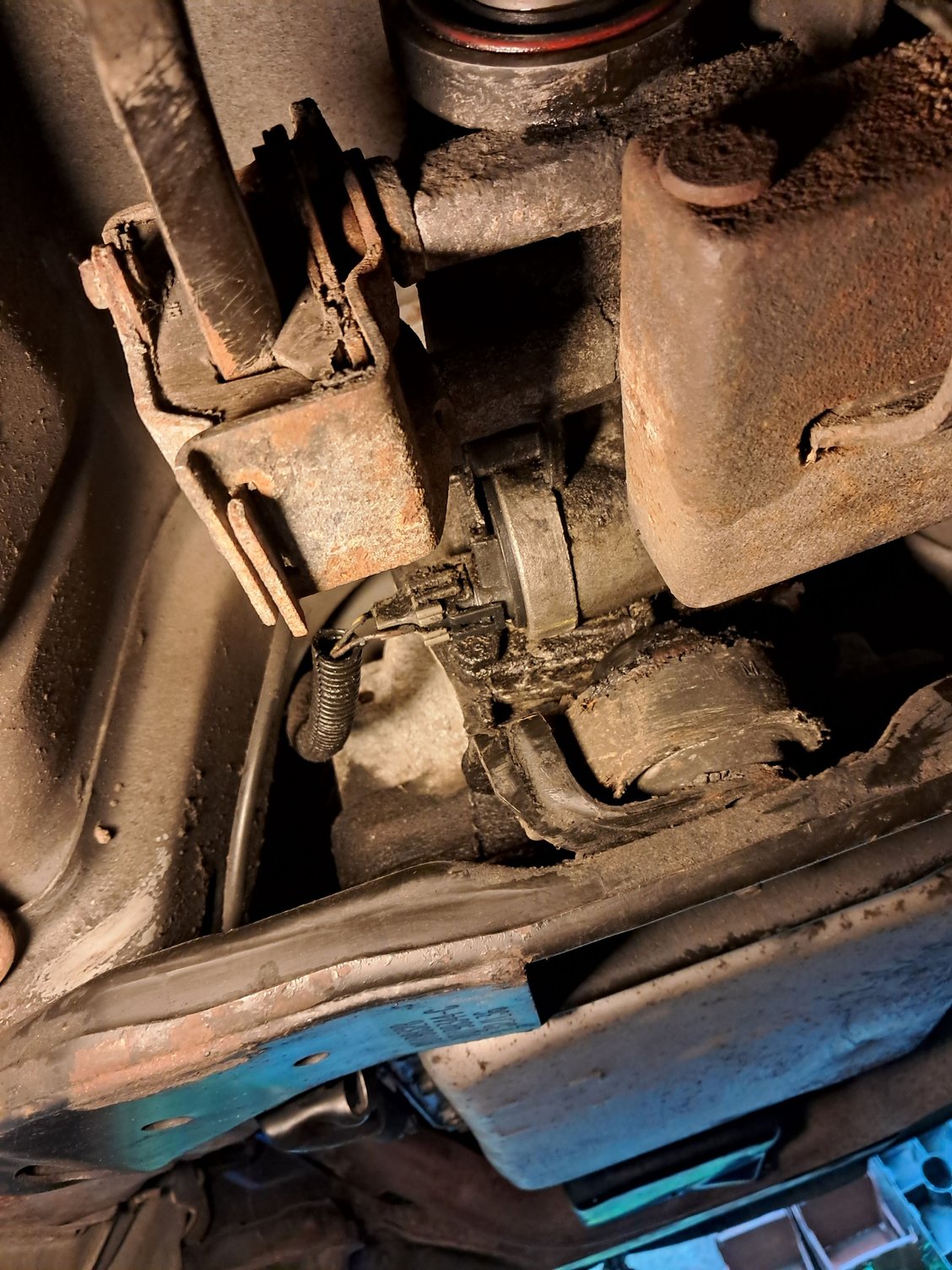

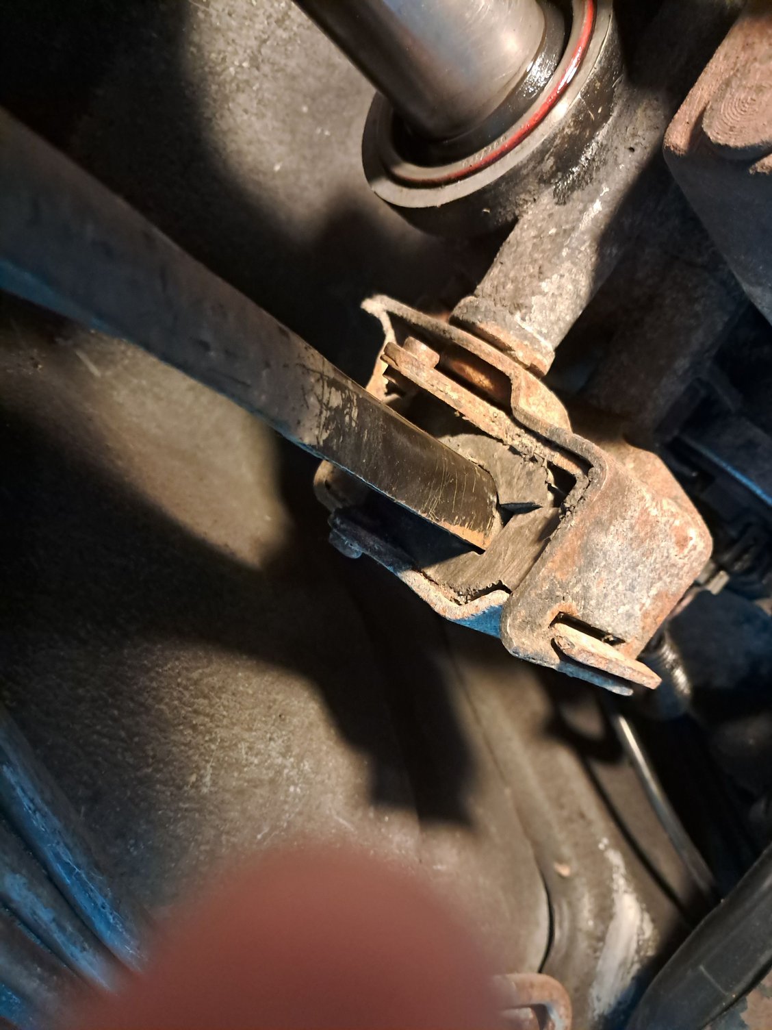

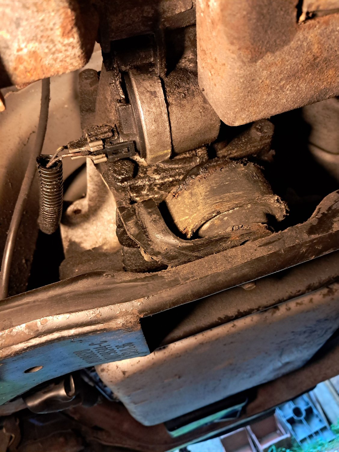

Well, the trans mount was complete toast. The inner bracket feels tight and looks fine, as you can see, so I didn't replace it (yet). Unfortunately, I still have the original vibration but with a slighter clunky sound/feel after reaching @45-50 mph & ONLY after coasting then accelerating. It is less pronounced than b4.
What exactly does the torque arm inner bracket "feel" like when its getting worn or shot completely? That smaller end of the torque arm just looks like it sits lazily in the inner bracket rubber bushing assembly. I assume the rubber bushing keeps the arm from excessive lateral movement but how exactly does it prevent fore/aft movement? It's really such a relatively "free travel" type bushing that's simply sandwiches the tiny end-piece of the torque arm but not with any serious compression, especially not enough to prevent for/aft travel.
Finally, is there ANY other thing that could cause my very specific symptoms? I assume an unbalanced driveshaft would get worse with acceleration.
