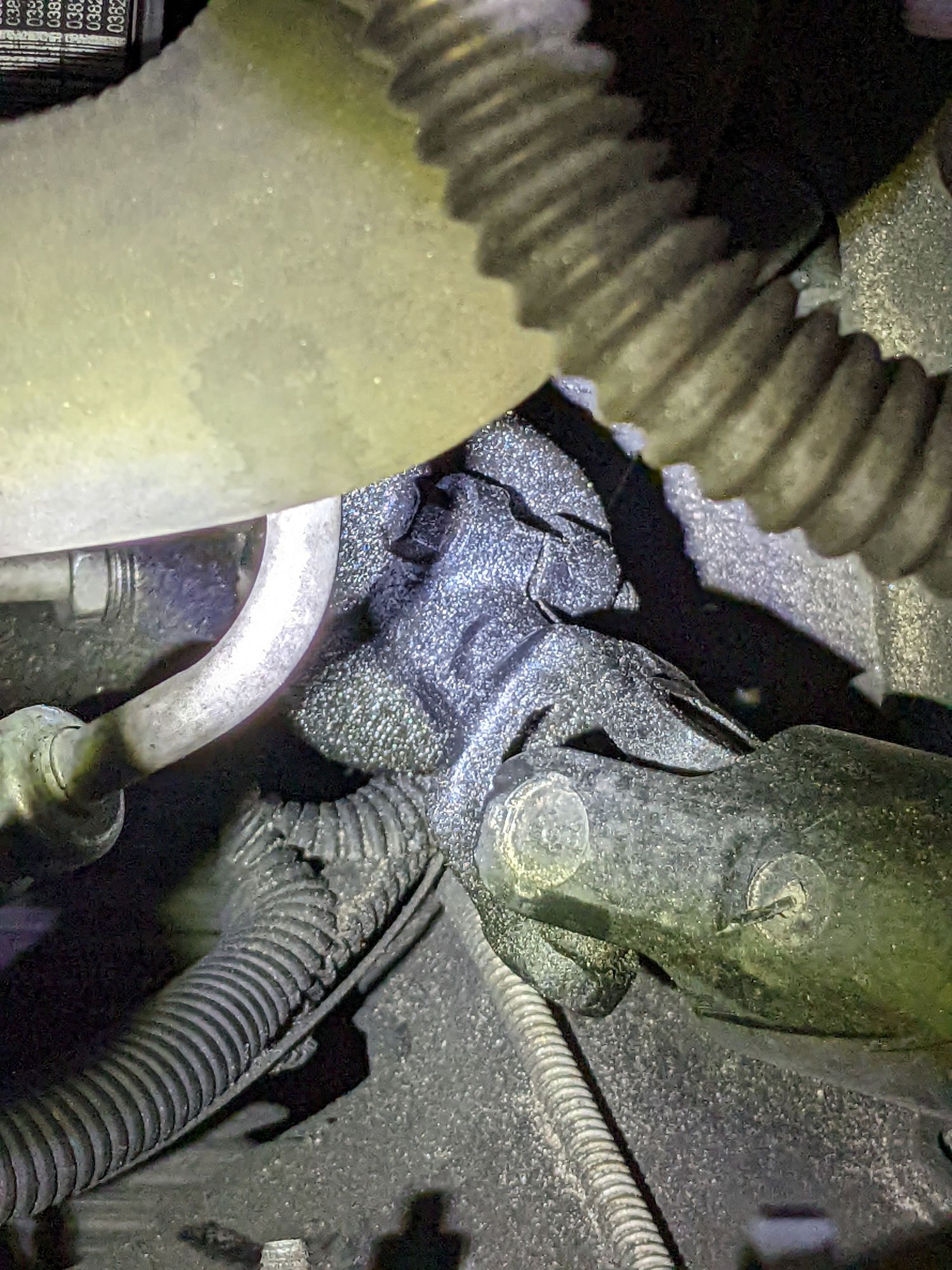

Default UPDATE: Clunking
Found out the intermediate steering shaft bottom u-joint connection to the rack is what's making the noise.
What a PITA trying to find a replacement! Had to buy a USED one from Hawks, with no idea how many miles it already has on it. So, thanks Hawks, but dammit.
And NO, it did NOT HAVE A RAG JOINT. That was half the frickin problem. Even the GM parts sites ALL listed the parts/numbers for the rag joint shafts. I had to take a picture of the one on the car and search ebay for a matching one just to get pointed in the right direction. (Pics to follow)
Now, I'm hoping it's as easy as it looks to replace, just 2 bolts. But no, I'm not holding breath that it will be, lol.
And why has Dorman created NEW intermediate steering shafts for the 2000 Monte Carlo, Cobalt, Impala, etc....but NOT CAMARO?
And...there is NOT ONE SINGLE YOUTUBE VIDEO on replacing it? The only 4th gen camaro ones they have are for the rag joints. The only steering shaft videos are for the pin or plastic bushings causing a wobbly steering wheel.
Wish me luck, tips and tricks much appreciated.

Default Intermediate steering shaft pics

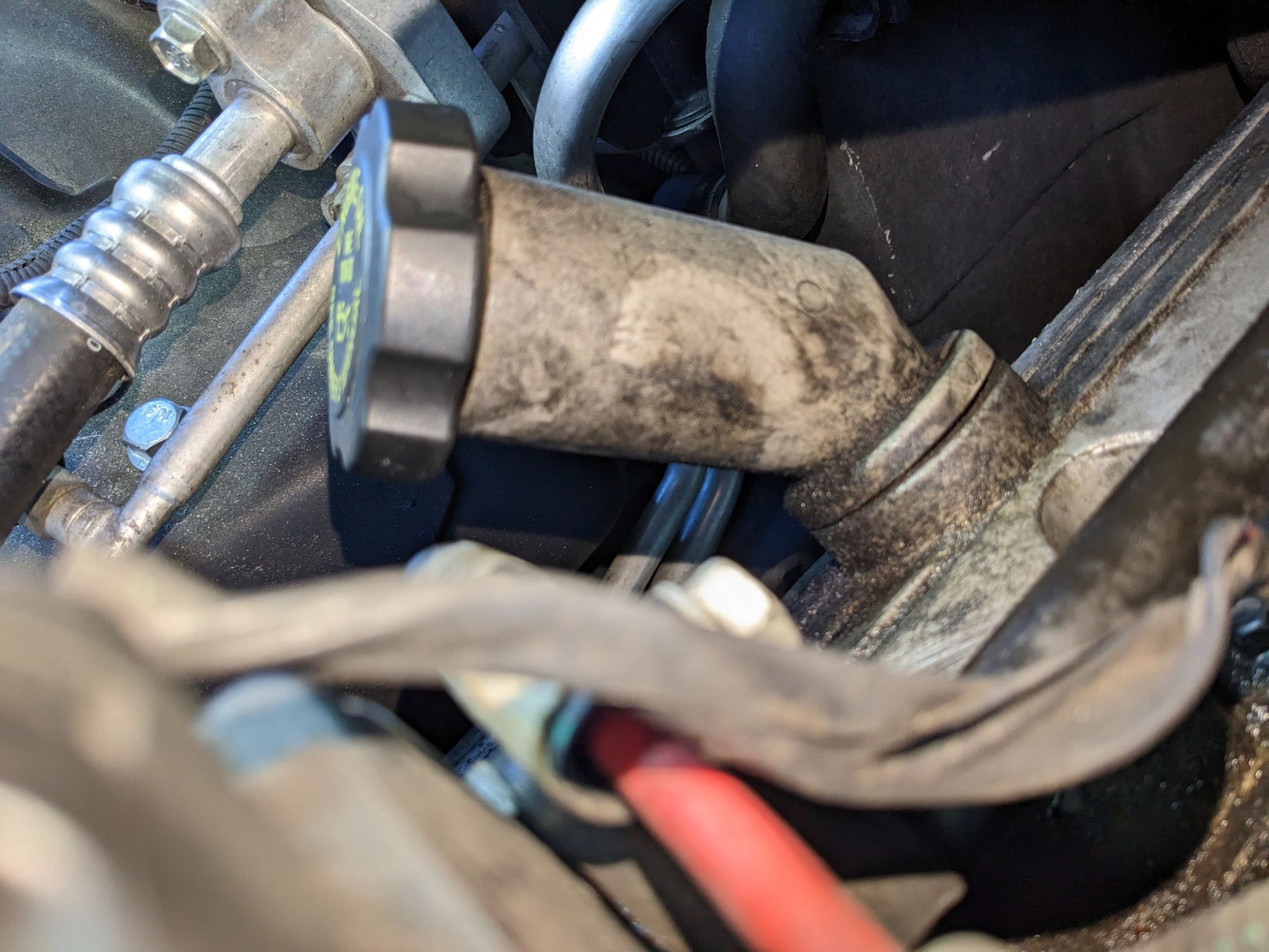

Default Update: Oil leak
I also found the source of my oil leak, I hope.
The mechanic that did my coilover assemblies said it looked like the valve cover gaskets. There is oil gunked on the covers and the bolts on both sides of the engine, but part of the intake manifold cover also has oil spray around the the PCV Valve cover.
So, it took some searching, but I was able to get replacement gaskets for cover plate. After replacing the valve, I cleaned off some the gunk with watered-down Dawn, a toothbrush, rinsed and wiped off with shop towels...hoping when I drove her again there would be no more leaks, or I could at least find where it was coming from, as it all looked like old oil gunk, no fresh oil residue was/is visible, but there was a growing puddle under the car every day, not much, just a tablespoon or so, but I had no leaks, at all for 22 years until the Valvoline quick change place my cousin took her to. I digress...
It appears to be from the Engine Oil Filler Tube connection to the valve cover.
I was bumping into it while wiping down to valve cover and the damn thing was just moving all over the place.
And once again, hours of searching for a discontinued part, or even replacement orings, no joy yet. I'm hoping the YouTube-rs are right and I can just remove the neck altogether and just screw the cap directly to the valve cover. But they were on LS1 and Silverado.
Any tips or advice appreciated
