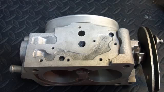

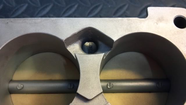

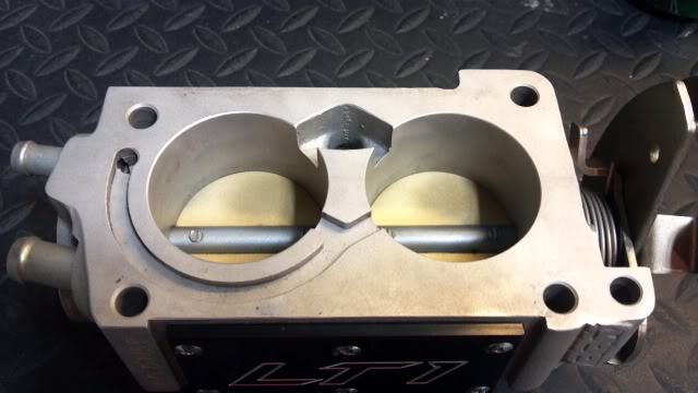

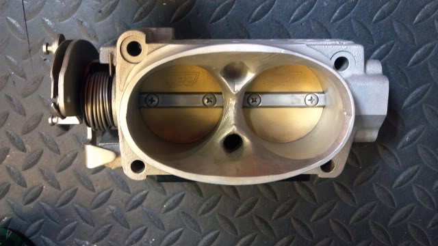

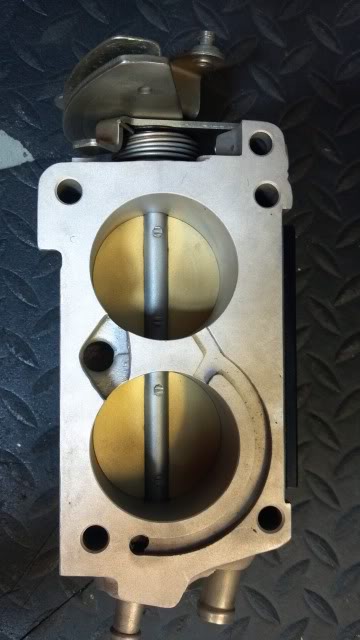

Second: I am trying to work on my TB while I have it off and need help. I have read up on the "drill-mod" for the IAC passage and cant seem to figure it out... It seems like my TB already has a passage to the IAC, and Im not sure where I am supposed to drill the hole (or if its even necessay in my case) The car does seem to react/idle better with the stock TB, but I also cleaned a lot of carbon and crap off of my IAC and the housing when I switched TB's. Here are the pics of my 52mm Edelbrock/BBK unit, can someone please help me with this? I dont want to have split BLM's with my tune and hope to hit the dragstrip this summer, so Id like this mod out of the way while the TB is off the car and all clean.
I assume I just need to insert a 1/2" piece of copper on the inside passage that is notched to not cover the hole?
