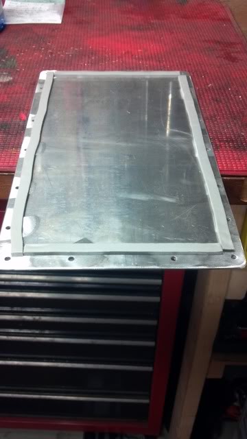

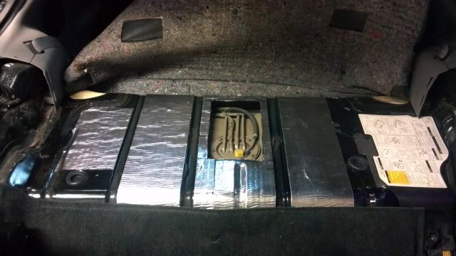

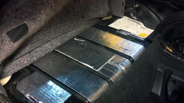

Well I was advised on a few things to check on the car that could contribute to my high H/C's, so I started with checking for fuel vapor leaks. I did the trap door mod because I was not dropping the tank just to check for leaks. I also plan on swapping to a hot wired Walboro 255 at some point, so it made sense to do this mod. Im not worried about cutting the car, its not some high option/rare car.
I also took the opportunity to install some additional sound deadener while I had everything out. I used Peel-N-Seal from Lowe's.
Anyway, I didnt see any leak points visually, but here are some pics.

I used aluminum for the cover plate, I had some clean, fairly thick pieces laying around.

I then used some foam weatherstrip to seal the door.

Somehow I didnt take a completed photo, but I screwed the cover down with small self tappers and put a piece of peel-n-seal on the top to keep it from vibrating.
