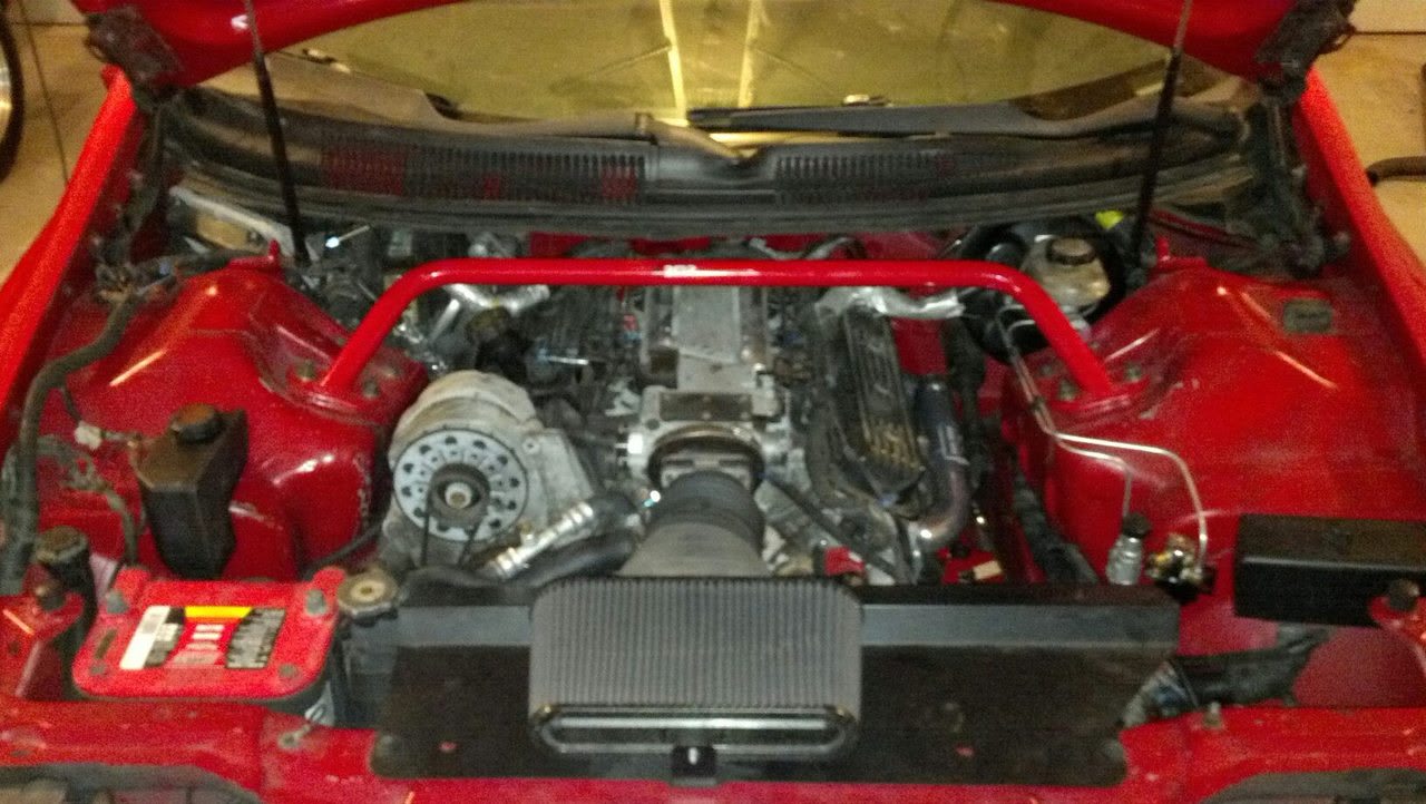

Update: got my tunnel mount torque arm in and the pinion angle set. Heres a quick shot of the engine bay. Everything is done and working now, I just need to bleed the brakes!

Looks great! Awesome swap thread.

Looks and sounds awesome. Inspires me to do the same if i keep it since the camaro wont be my daily driver.
