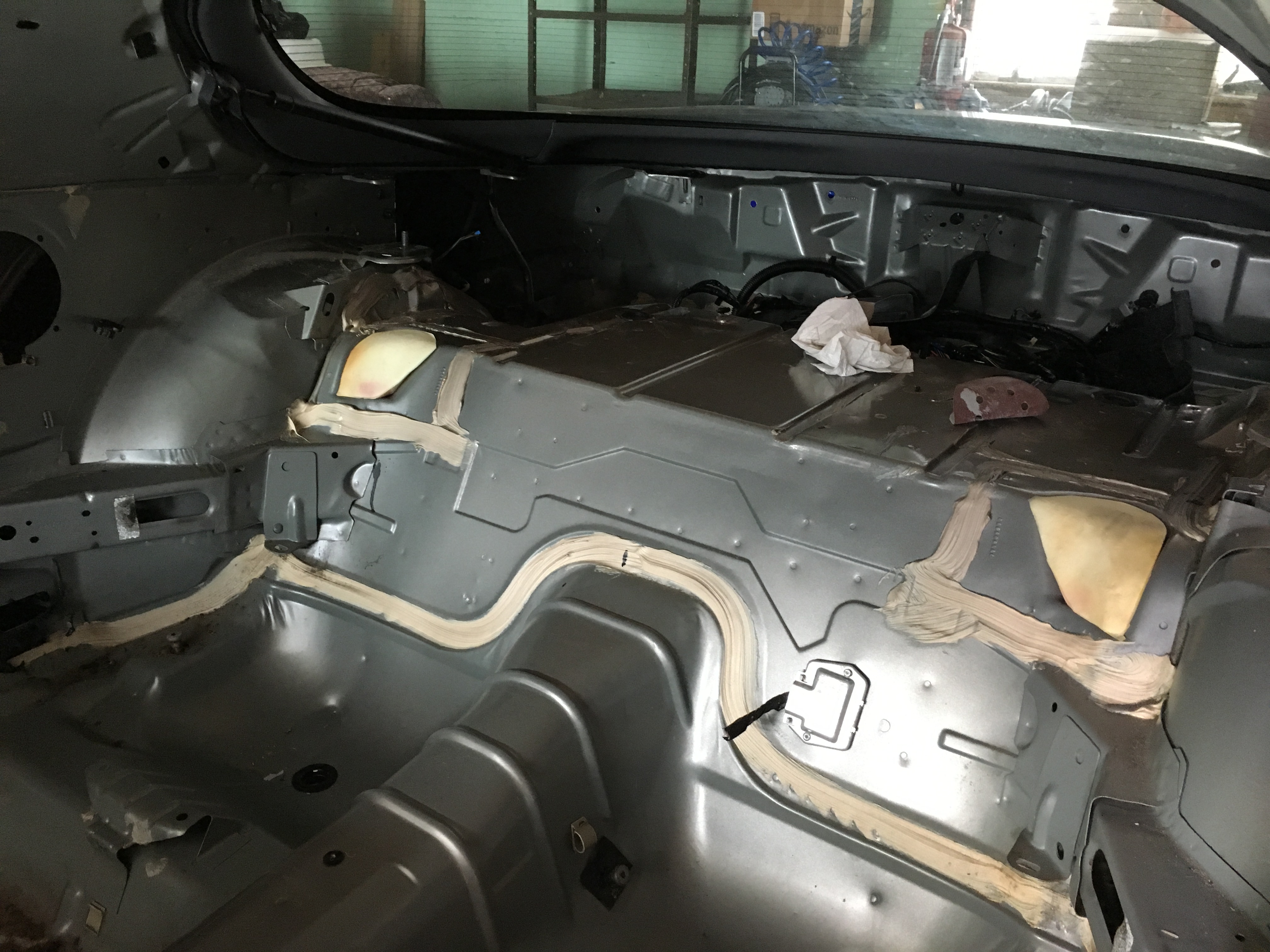

In the second photo, does anyone know what that metal box with wires going in it is behind the back seat. It's riveted to the floor, I cut the wires removing the interior harness. I'll splice them back together if it's something I need.

Should've bought a built roller for 4-6k that already has a cage, 9" etc already done. But hey its your project. The wires/box is fuel pump/ABS plug. Why would you cut the wires to the harness? You can unplug and remove every wire in the car without cutting.....I've done it
Thanks Socom, The box didn't have a plug, everything else removeed without a problem. I'll, splice everything back together when it comes time. I left enough wire to work with, when it comes to that. As for finding a 4th gen built roller, they're not that easy to come by here in Delaware. I've been looking for a little over a year now, so I decided to find a cheap roller and do the work myself.
