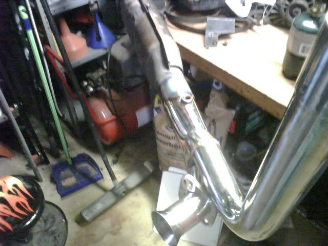

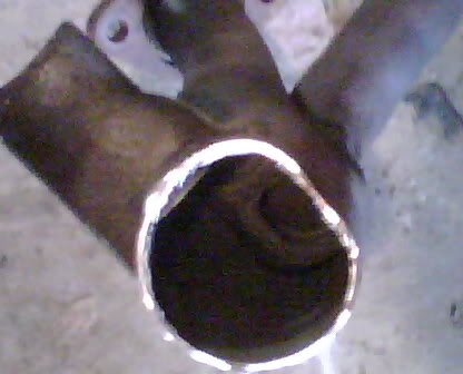

Old Aug 2, 2009 | 02:28 PM
  #59
Installing the old Cat with the new Y-pipe was more work then I expected. First where I cut the cat is not round. It was almost a D shape. I am not sure if this is normal or not
So I hammered and dollied it into shape and put an ID chamfer on the tube. In that process I think I streched the metal cause the tubes are now about the same size. So I go may torches out and shrank the Cat tube. I then had to heated up the Y-pipe with some propane and drove it on. I will put a clamp on just to be sure but that will not be fun to get back apart.

Old Aug 4, 2009 | 02:32 AM
  #60
MusicMan's Avatar
The Jazz Man
Joined: Mar 2008
Posts: 2,237
From: St. Helens, Oregon
Any reason on using the stock cat? Budget I assume? I would be worried about the catalyst with all that hammering and heating to get it to fit, might have warped the casing, honey comb might break free.
