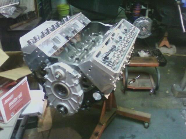

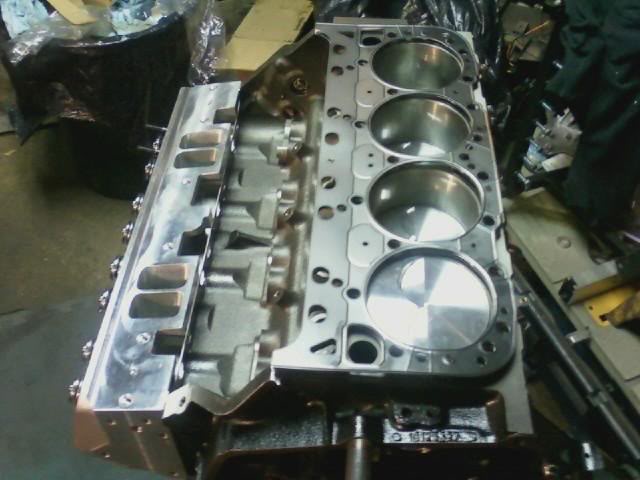

well last night went well. hit one bump in the road but cruised the rest of the way. we hav a short block. pistons r in rod bolts reclearanced and torqued the cam is in and degreed the whole timing chain set up is on as well. the one thing that we had a problem with is the rods needed to be spun around because there's a thicker side and we had it facing wrong. so here's the pics i took throughout the night. tonight we'll get some play doe and check the valve clearance

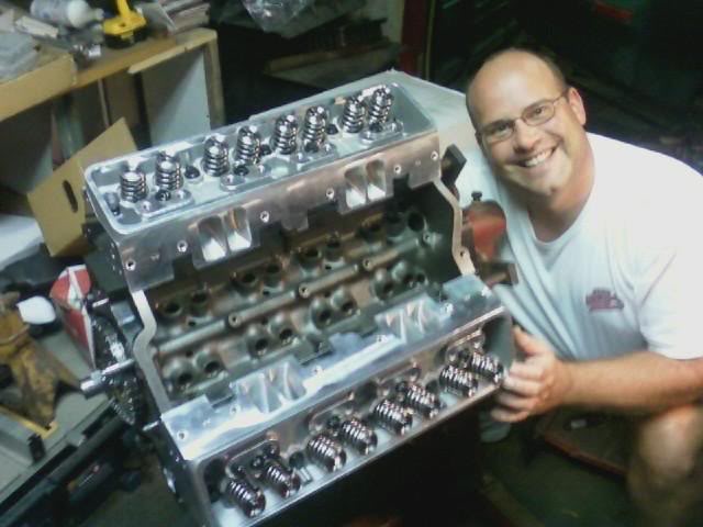

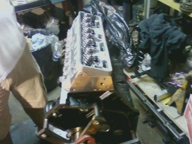

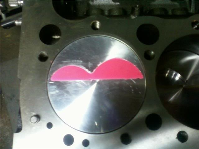

well we went out last night and played with play dough lol. we actually used play dough to check valve clearance which there was plenty of clearance. then we bolted the heads down. here's some pics hopefully there big.
