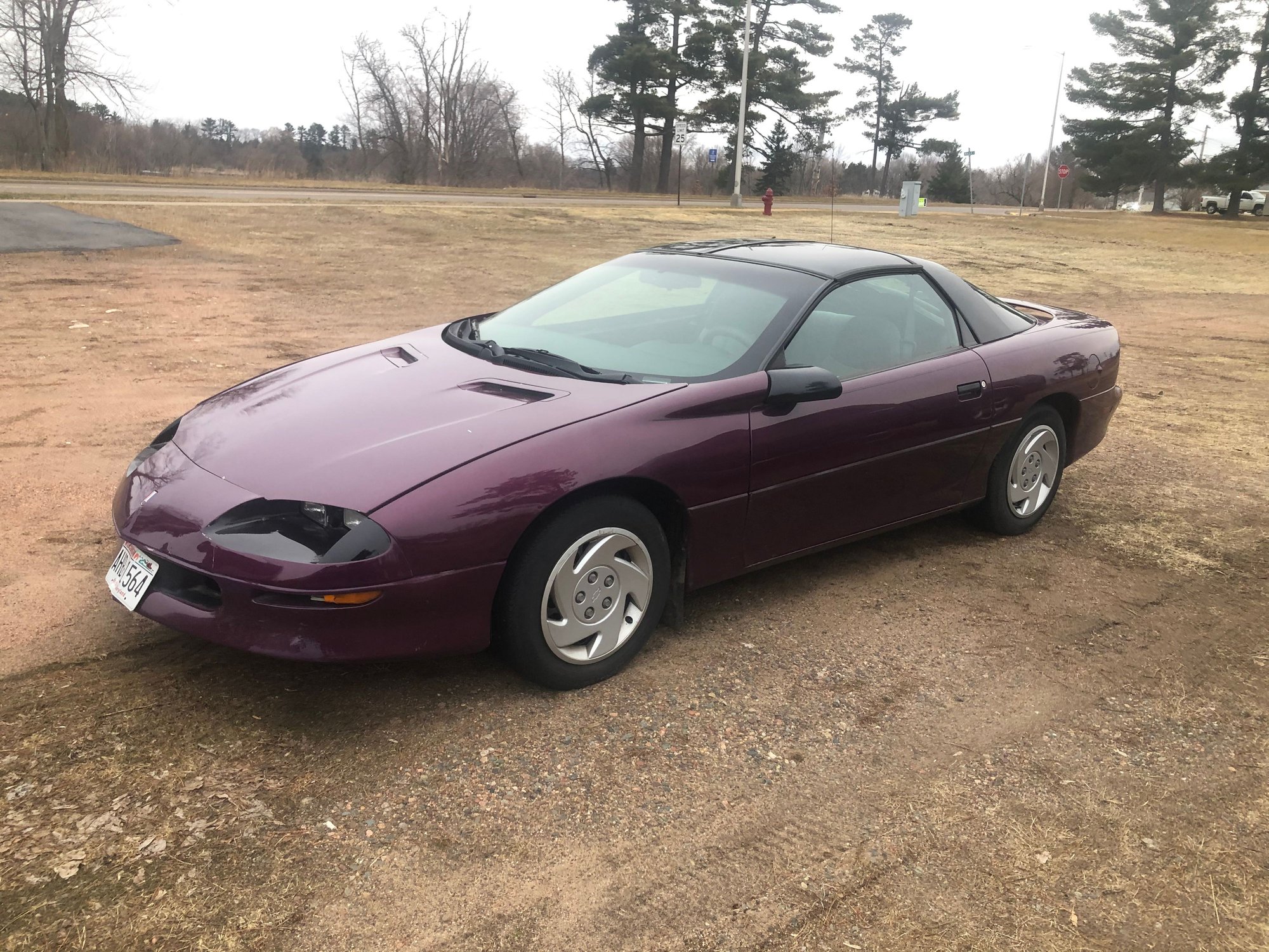

Asking thoughts/any words of advice from people that have seen/done weird swaps. I’m thinking about swapping a similarly sized Nissan v6 into my 95 3.4l Camaro. I’ve seen forums asking about doing this to a 3rd Gen and nobody was really helpful. I know everyone’s first suggestion is to go LS or LT swap but that seems like a lot of work with suspension and whatnot. I’m thinking of doing the 3l VG30DETT engine/transmission/ecu out of the 300zx mated to a custom driveshaft. I decided on the VG for the iron block and aluminum heads, and it seems like less technology to deal with over the VQs from the 350z. This wouldn’t be a daily more of a fast beater/sleeper. A junkyard 350 or Z28 would be cheaper yes, but where’s the fun in doing what everyone else is doing? The current goal is about 600hp but really 450 would be enough to hang with some of my other friends cars. Plus it would be pretty fun to put the gap on my buddies 5.0 Fox Body with a v6.
Again not really sure what I’m asking here just needed some place to have a conversation about it.
