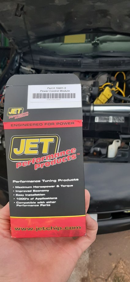

Jet stage 2 performance module

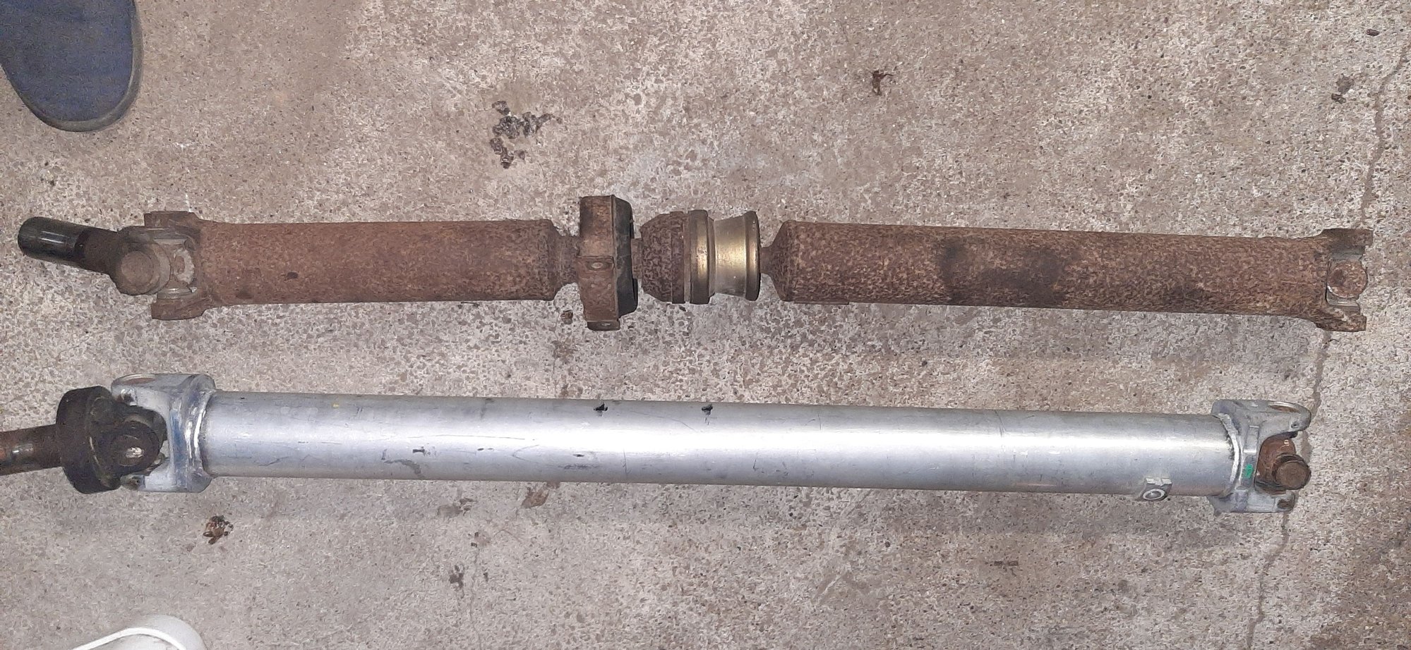

1 piece aluminum driveshaft from SS model

Phew! That took a bit of thinking! I'm gonna attach what pics I can to this thread, and if ya wanna know about anything I'd be happy to answer.

Stock 2 piece steel vs 1 piece aluminum driveshaft
