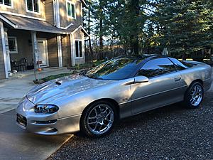

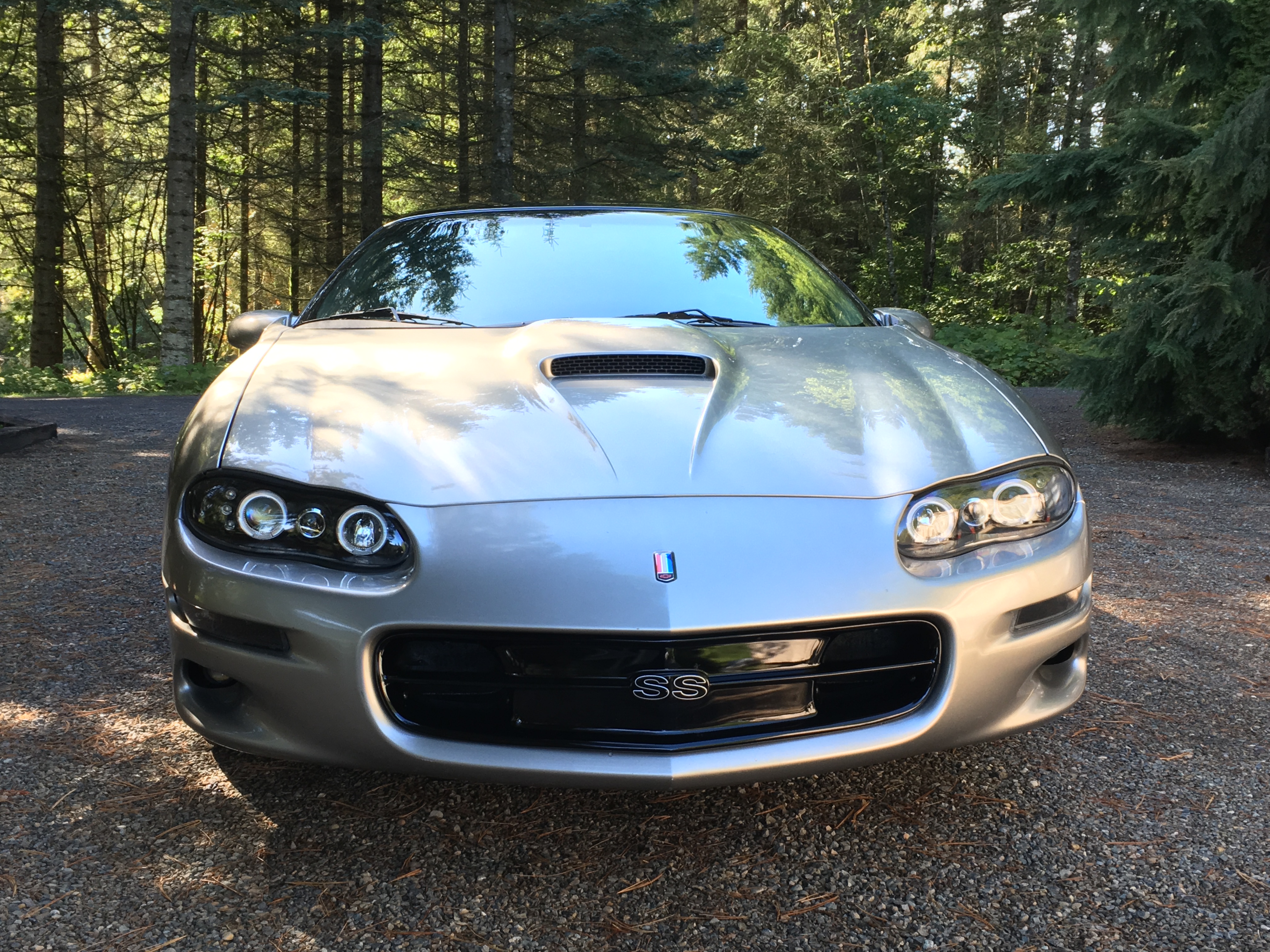

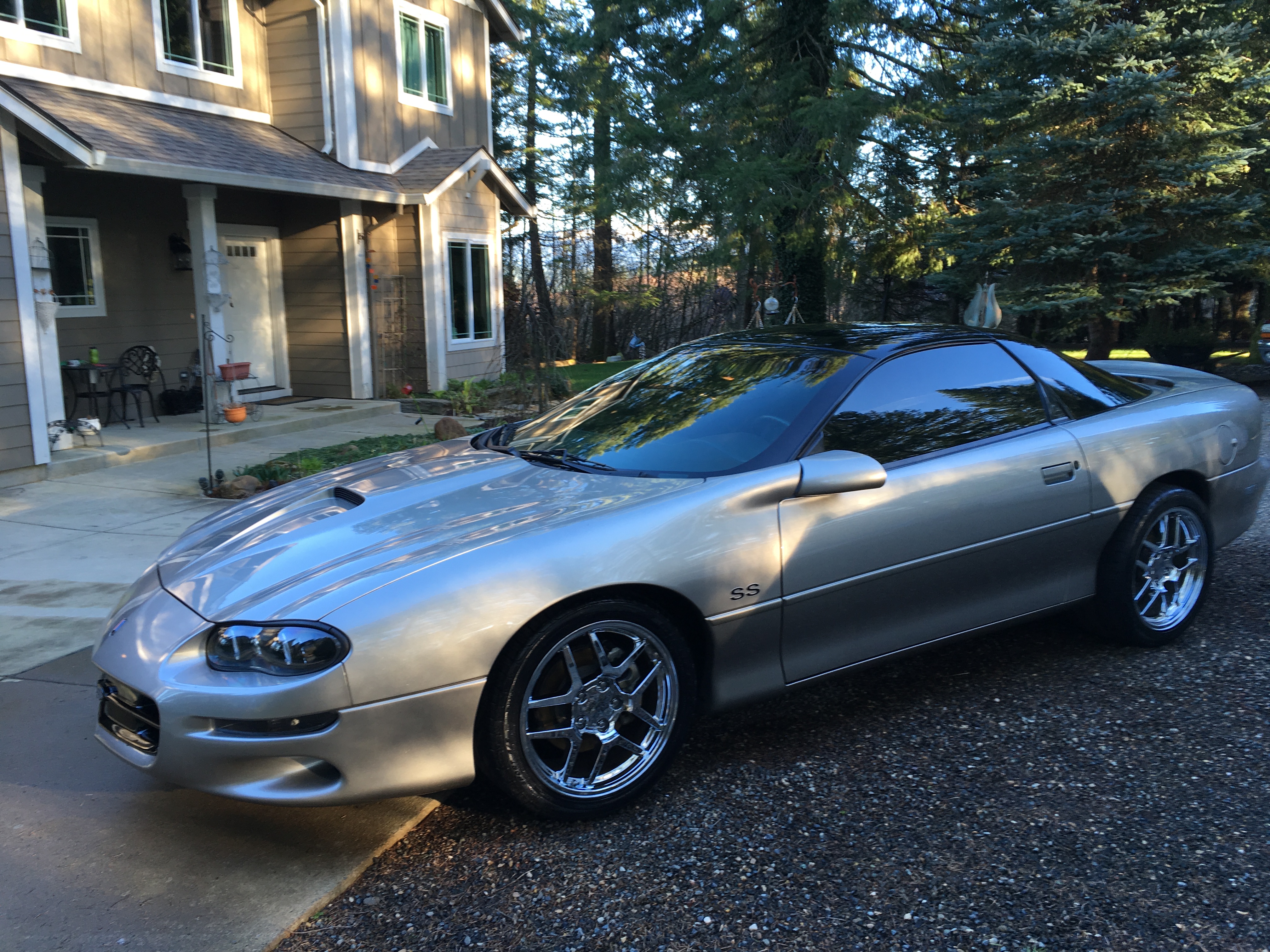

Originally Posted by Chaotic94
Thats a slick car Y2K!!!
She had one re-paint before I bought her with 176K miles and looked and ran pretty good for the miles and age.
222,000 miles on the clock when I let her go for this one, my 2001 SS.
This car only had 86K and still has only 87k now,many mods done so far and a few to go yet.
Here's the list:
Engine & drivetrain
Original numbers matching 2001 LS1 @87K miles.
2004 LS6 Corvette Z06 heads with Comp Cams double springs.
Comp Cams .617 lift. camhaft.
GM Performance LS7 lifters.
Comp Cams hardened pushrods.
Katech C5-R timing chain on new GM Performance sprockets.
GM Performance oil pump.
Prothane poly motor and trans mounts.
Ram 19.5 lb aluminum flywheel.
GM Performance LS7 clutch kit.
ARP flywheel and pressure plate bolts.
Tick Performance adjustable clutch master cylinder.
GM Performance clutch slave cylinder with Tick Performance speed bleeder.
MGW short throw shifter.
American Racing stainless steel long tube headers and of road y-pipe (no cats)
GMMG chambered exhaust.
Dynotune by Corvette guru Tom Wong at Wong's Performance.
Chassis
UMI roadrace tube front K-member.
UMI tube lower A-arms.
Global West tube upper A-arms with added camber and geometry corrected ball joints.
BMR front shock tower brace.
Strano clutch master/firewall brace.
BMR bolt on subframe connectors.
Mid West Chassis drivelive loop.
BMR tube torque arm and relocation bracket.
UMI tube poly roto-joint rear lower control arms.
BMR tube adjustable panhard rod.
Strano handling package # 6
1 set of 4 (2 front, 2 rear) Koni "4/3" Sport shocks. Off-car adjustable rear shocks.
1 set Strano Performance SP141 1.2" lowering springs.
1 set Strano Performance Hollow Sway bars 35mm front,22mm rear
Z06 style chrome 18" wheels
10.5" rear and 9.5 front"
2X 20mm Hubcentric Wheel Spacers 5x4.75 5x120.65 5x120.7 for rear wheels and 2.5" 12x1.5 .509 knurl ARP wheels studs.
Michelin Pilot Sport 275/35-18 front tires
Michelin Pilot Sport 315/30-18 rear tires.
Custome halo projector headlights,custom tail lights ,turn signals and side markers
New SLP SS grille.
Attached Thumbnails Chaotic's Z28 Progress Thread-010.jpg   Chaotic's Z28 Progress Thread-013.jpg
