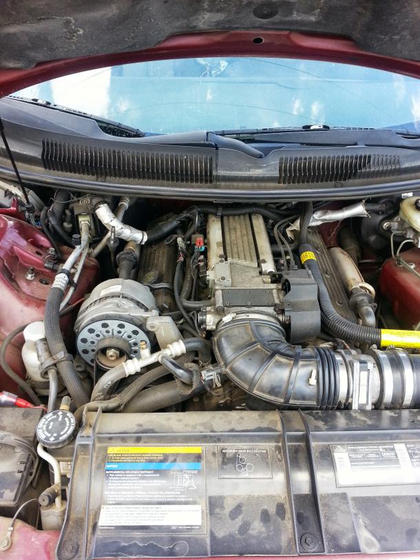

volts are low, should be 13+ volts, knock count is high. you may have 02 simulators on it. is there anything hooked to the 2 wires, one should be by the passenger side exhaust other comes out of the harness that goes to the trans.

The hack job I'm dealing with on replacing the exhaust with something smoggable. Also adding photos of the engine bay..let me know if you see anything weird..there is also an MSD CARB badge on the drivers side..assuming MSD Optispark?
Attached Thumbnails 94 B4C Build-20130722_115235.jpg   94 B4C Build-20130722_115300.jpg   94 B4C Build-20131005_102844.jpg   94 B4C Build-20131005_103401.jpg   94 B4C Build-20131005_103409.jpg
