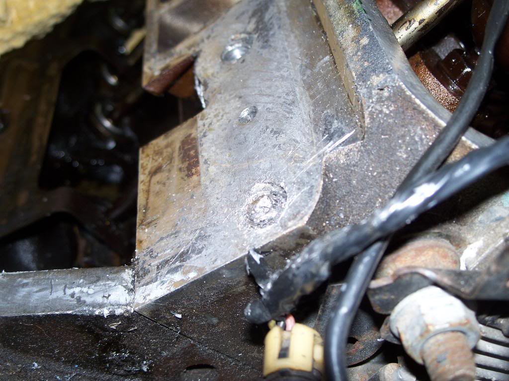

This was about the best picture I could get:

what size of drill bit you using. should be fairly small to get a pilot hole.

Looks like you can even use a 1/16 or 1/32 drill bit to get a good pilot hole (Of course, drilling slowly as not to break the bit), then use a good sharp screw extractor to get it out. That's my
(Also, probably a good idea to give that area a good thorough cleaning. Looks to me like you've got some shavings there)

I think I was trying to use a 1/8" bit. When I was trying before I tried using a center punch to make a dimple, but it just flattened the punch. So naturally I couldn't get the bit to stay in one place long enough to actually make a hole. Also, because it's pitched up at an angle because it's in the head, It's very difficult to get axial force on it decently.

the smaller the drill bit the better to start with. dont want to break the bit though so gota be carefull. got a dremel bit small enough to get in there to flatten it?
