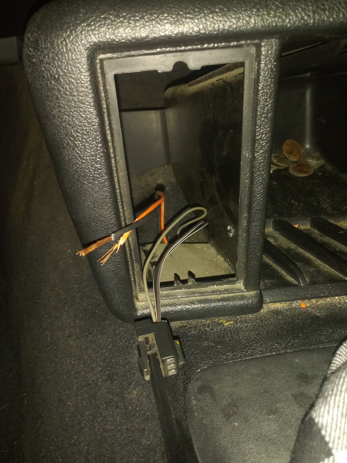

Recently bought a 95 camaro 3.4l 5 speed. The cigarette lighter panel was missing and had a aftermarket cigarette lighter hooked up and There is a random plug eith the cigarette lighter wires. Its plugged into nothing, Can anyone tell me what is supposed to be with the cigarette lighter. Thanks in advance.

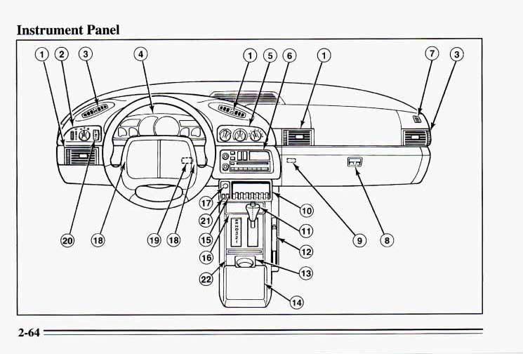

The 1995 Owners Manual shows the area would have the cigarette lighter, traction control and convertible top switches (if equipped).

After thinking about this for a while, the thought came to me to check a schematic to see how many conductors would have gone to the ASR switch and what colors they were. As you see in the picture below, they match with what is shown in your picture.

It'll have the wiring for it even if the car was not equipped. It's easier (and cheaper) to make one harness that fits all the cars, rather than make one for each individual option.

Thank you for the info. Mine isnt equipped with it i found out last night. Was just wanting to make sure i didnt need to find a certain switch or anything.
