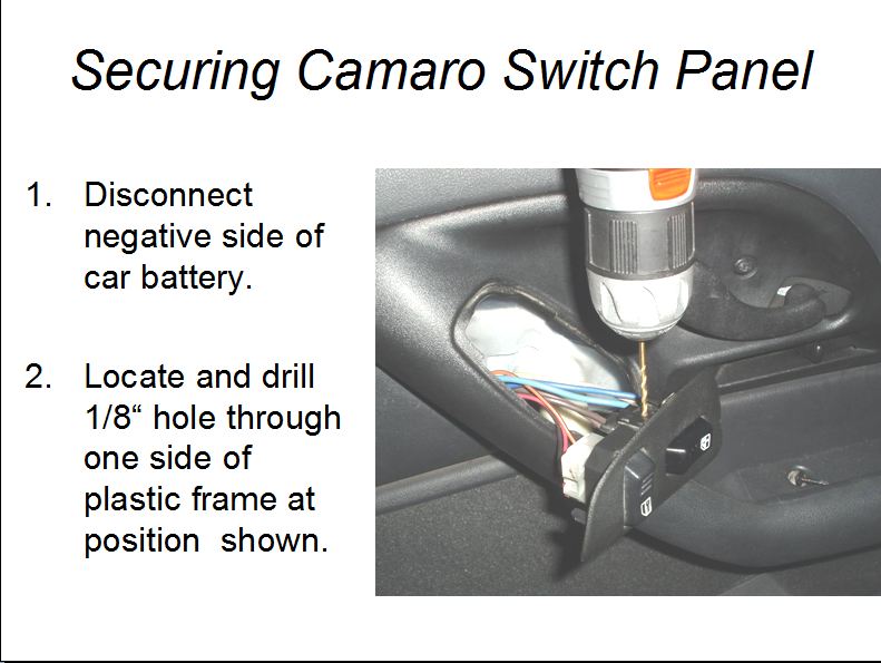

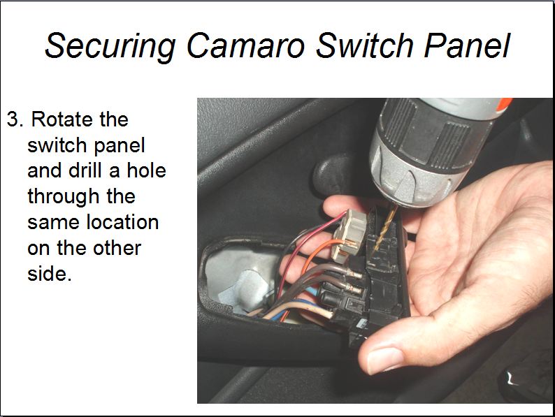

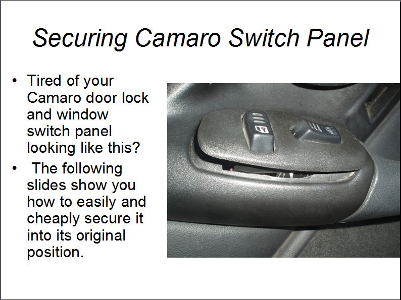

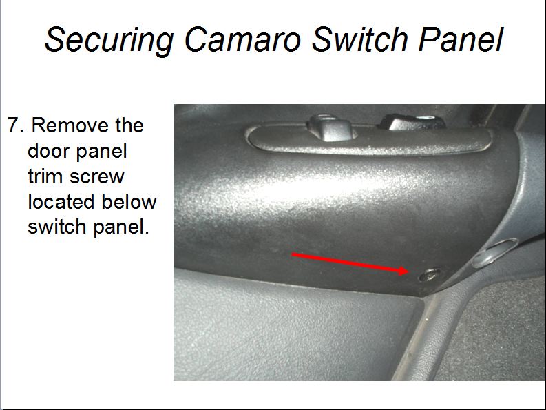

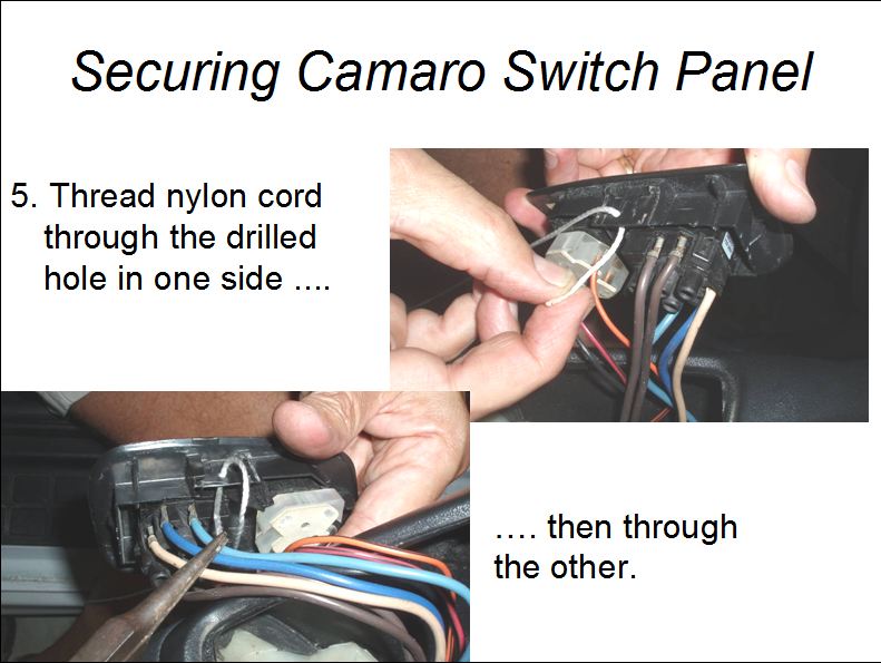

Post cheap broken switch panel repair (part 1)
part 1
The following instructions depict how to cheaply repair a broken automatic switch panel. the other photos that complete this manual can be found in threads "cheap broken switch panel repair (part 2)" and "cheap broken switch panel repair (part 3)" due to upload restrictions.
Attached Thumbnails cheap broken switch panel repair (part 1)-repair-1.jpg   cheap broken switch panel repair (part 1)-repair-2.jpg   cheap broken switch panel repair (part 1)-repair-3.jpg   cheap broken switch panel repair (part 1)-repair-4.jpg   cheap broken switch panel repair (part 1)-repair-5.jpg

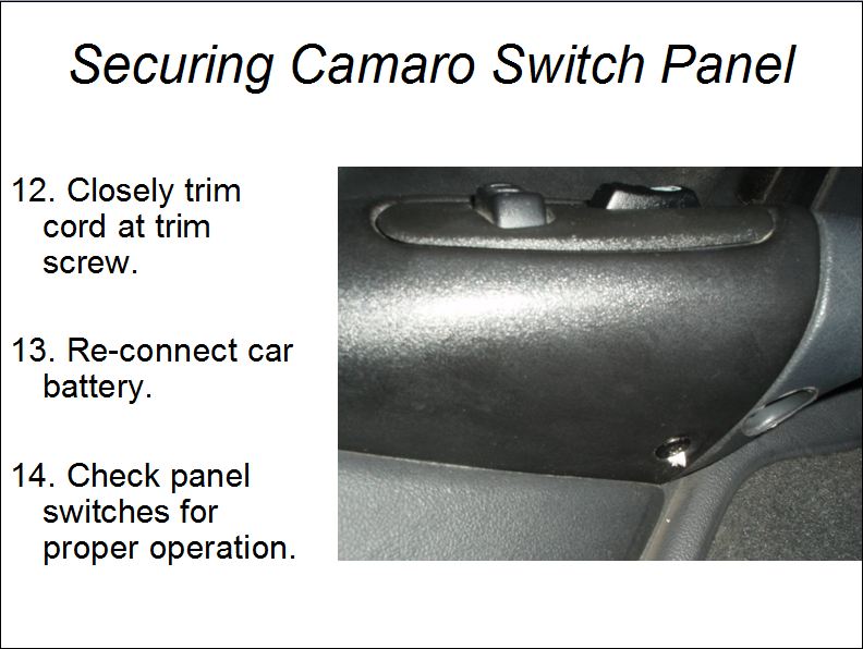

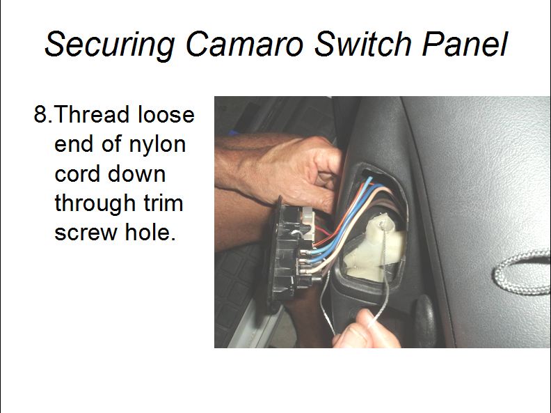

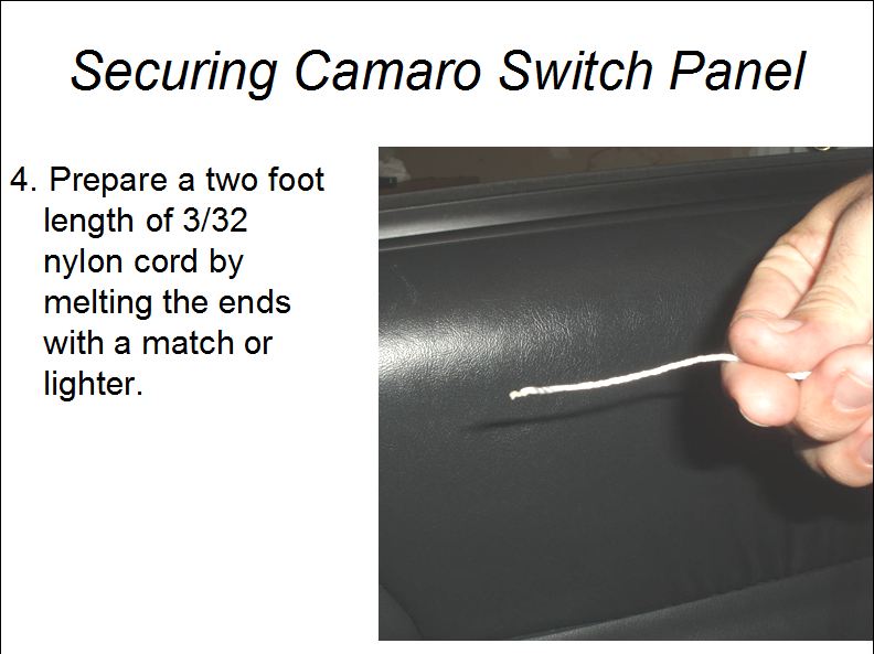

Post cheap broken switch panel repair (part 2)
Part 2
The following instructions depict how to cheaply repair a broken automatic switch panel. the other photos that complete this manual can be found in threads "cheap broken switch panel repair (part 1)" and "cheap broken switch panel repair (part 3)" due to upload restrictions.
Attached Thumbnails cheap broken switch panel repair (part 1)-repair-6.jpg   cheap broken switch panel repair (part 1)-repair-7.jpg   cheap broken switch panel repair (part 1)-repair-8.jpg   cheap broken switch panel repair (part 1)-repair-9.jpg   cheap broken switch panel repair (part 1)-repair-10.jpg
