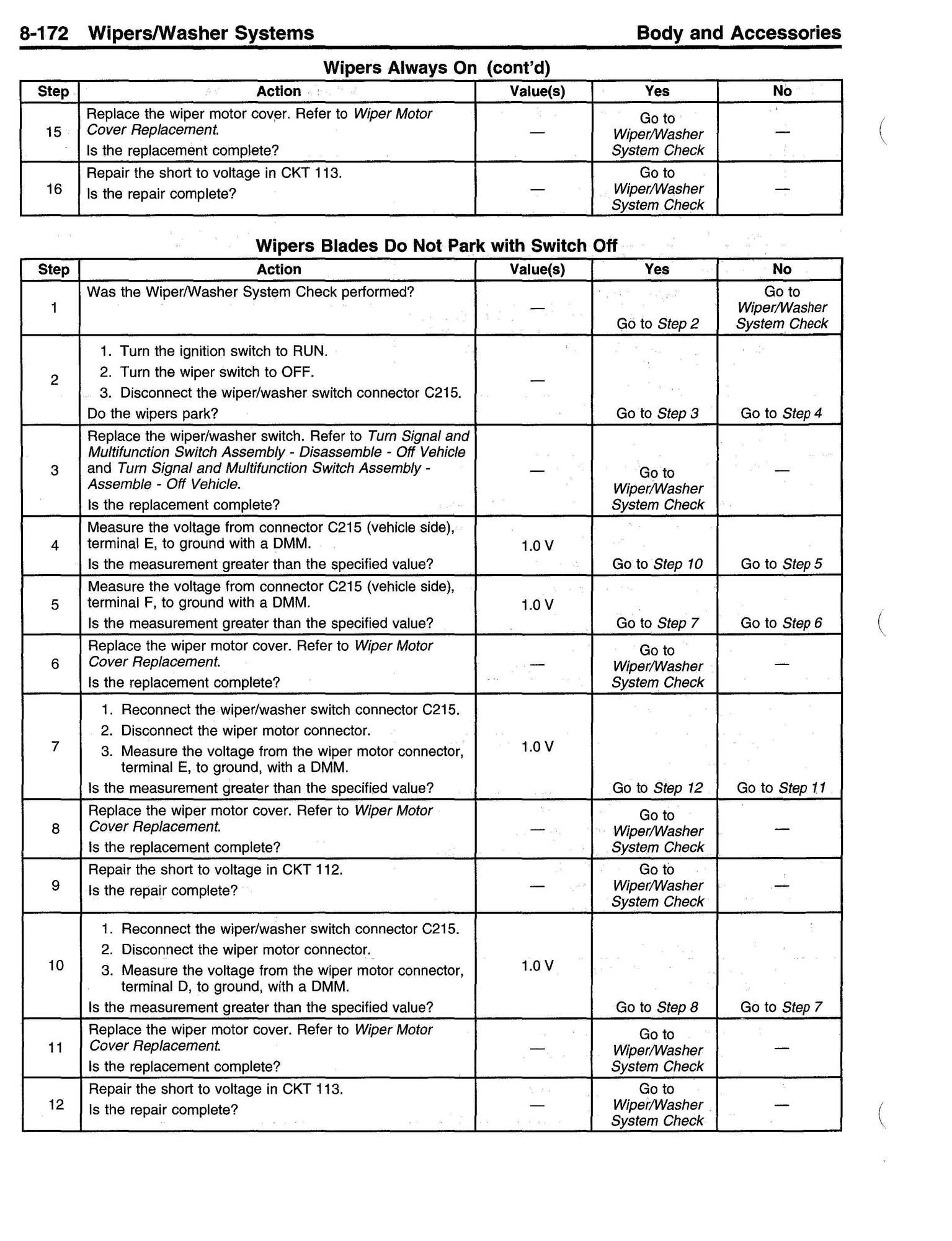

See if these two pages from the 98 service manual helps.
