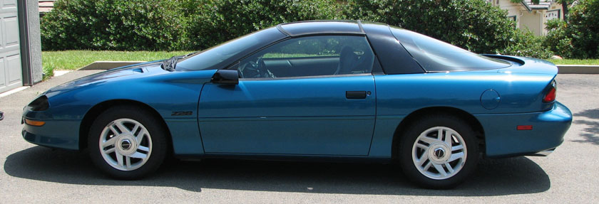

Used A/C stripper today - stripped 1 wheel - took clear coat and sparkely finish off after leaving on for 30 minutes - works well - going to do other 3 tomorrow - then going to paint rims black - leaving lip edge shiny silver and using stock center caps. Should be pretty cool!
