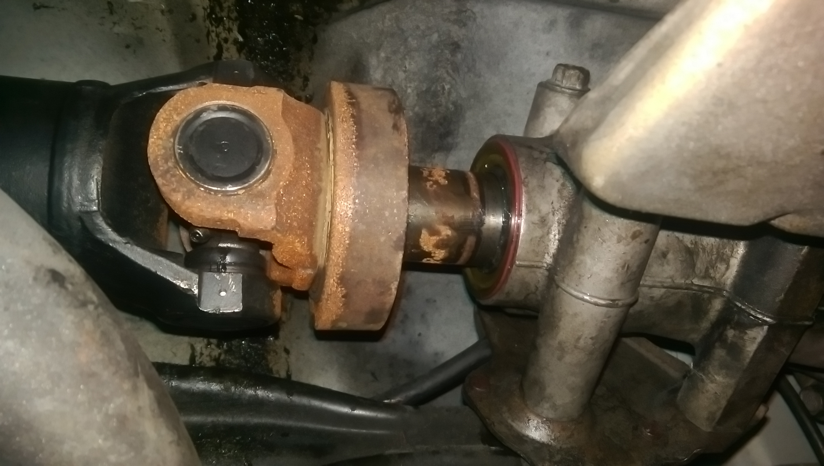

Found another problem, that's causing the majority of the vibration.
Doesn't that look a little short?
Like, over an inch too short?

looks pretty normal. shaft goes in and out when the rear of the car goes up and down. lol. i have been searching for cause of vibration in mine for years. replaced drive shaft, reared, lower control arms, sway bars, panhard bar, torque bar, transmission, engine, pretty much everything and its still doing it. adjusting the torque bar has helped. changed one motor mount and it helped so im going to change other and see what happens. it was sagging pretty bad, didnt think the other looked so bad. next im going to measure the rearend to make double sure its squared up.

If you took that picture with the rear wheels off the ground, the axle droop will pull the driveshaft slip yoke out some. You want the yoke pulled out a minimum of 3/4" from where it's bottomed out, no more than 1" is desirable but not the law. If you really want to know what you have, you need to disconnect the driveshaft at the rear to know where bottom is, and the end play is checked only when the weight of the car is on the rear wheels. If you're getting vibrations from that spot, either your tail housing output bushing is shot, or the u-joint is.

Both of those have been replaced, the bushing and the u-joints.
It did have a worrying amount of play on it though when it was up there, could really clunk it around up and down just by hand.
-edit-
The car was on a lift when we took that picture there.

may want to have a look at the gears inside the end and on the trans shaft. one or both could be worn
