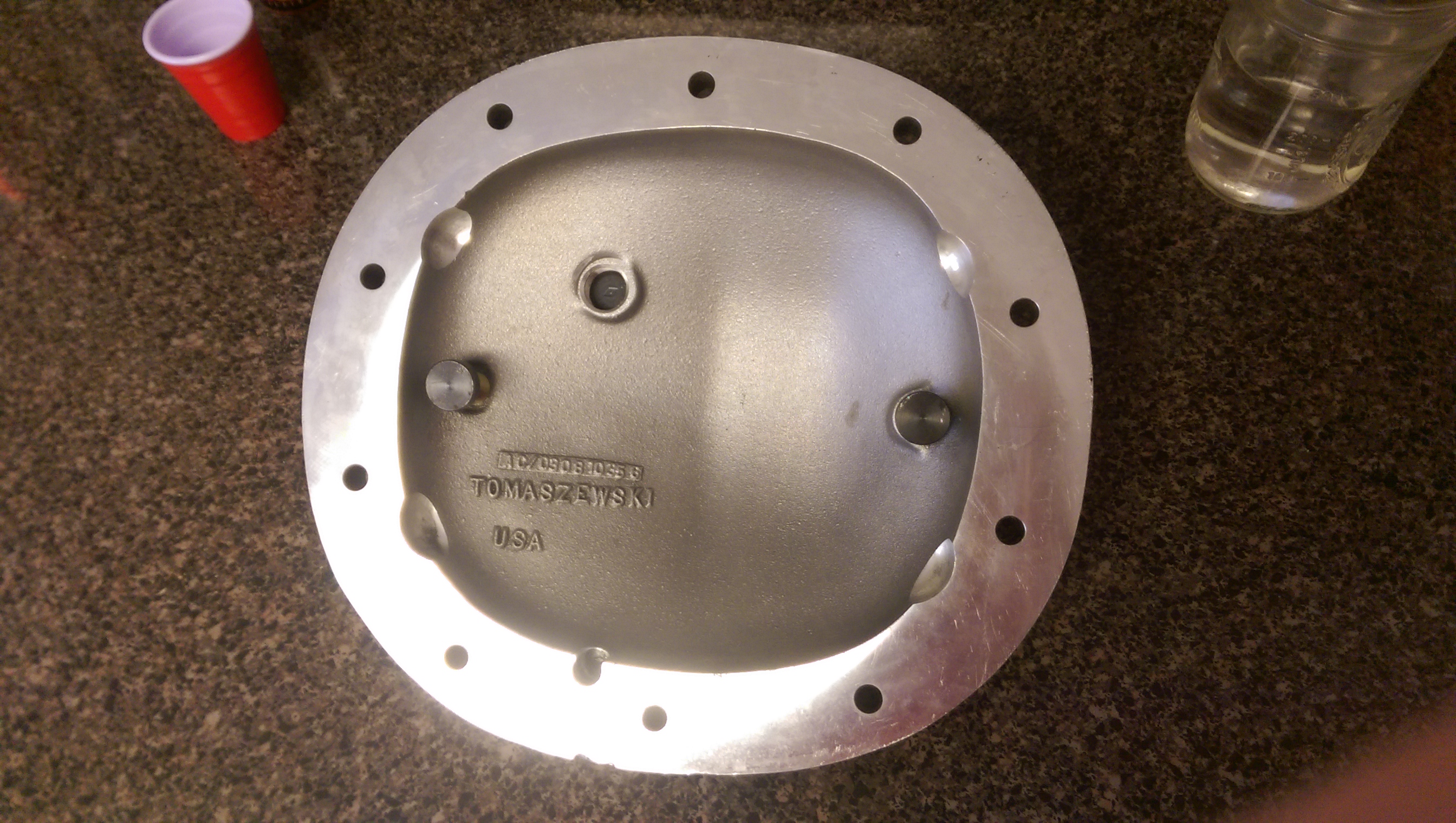

Got the differential cover. Cleaned up, looks good.
-edit-
Please excuse the red solo cup shot glass there, and the mason jar full of.... -erhhrmm- water.

Old Dec 19, 2015 | 05:53 AM
  #94
Posts: 22,016
kool, gots a drain hole. now thats a upgrade.

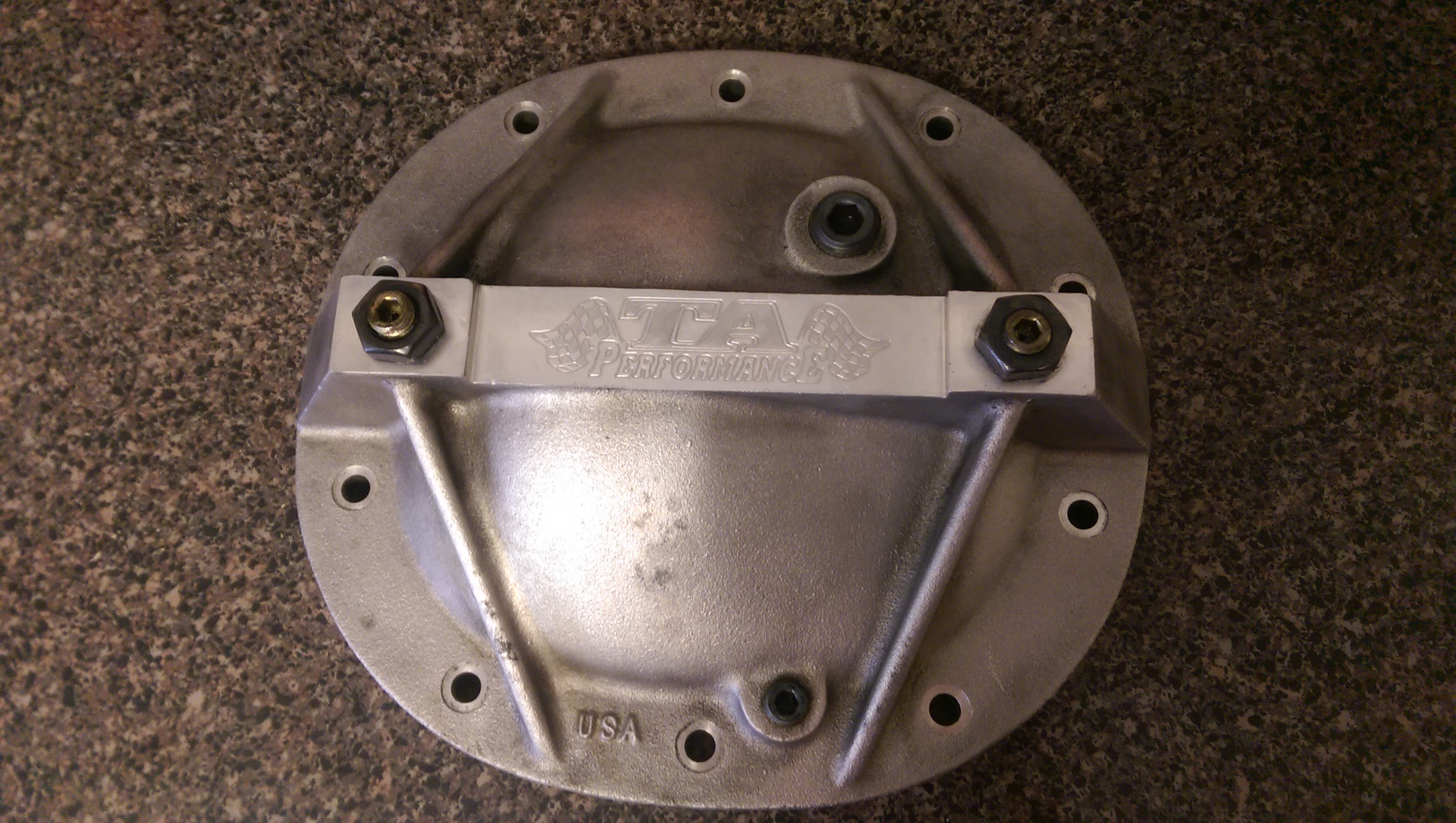

Yeah, I looked it up earlier, it's about $200 with a stud kit and all.
It's actually referred to as a girdle, not just a cover, and I see why.
It's braced on the front, and it's actually about 50% thicker than a stock cover.
I'll have to spend like $30 for the stud kit and some new deals, but that's peanuts for what it is
Old Dec 19, 2015 | 09:42 AM
  #96
Posts: 22,016
it stiffens up the center. these rearends flex at the center when the touque gets up there. tends to cause things to fail. i think theres a bar you can get to to help the tubes to stay in place.
