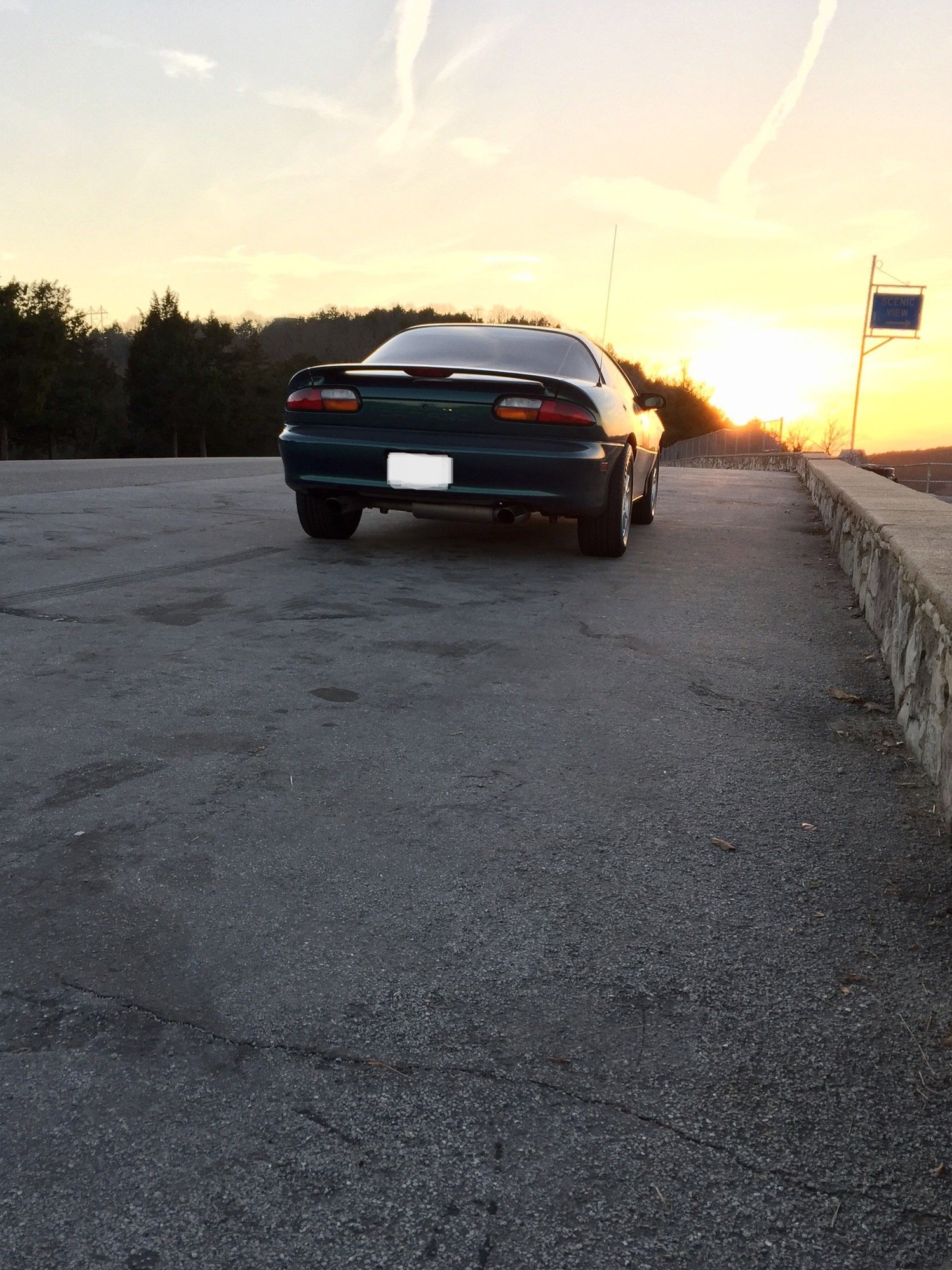

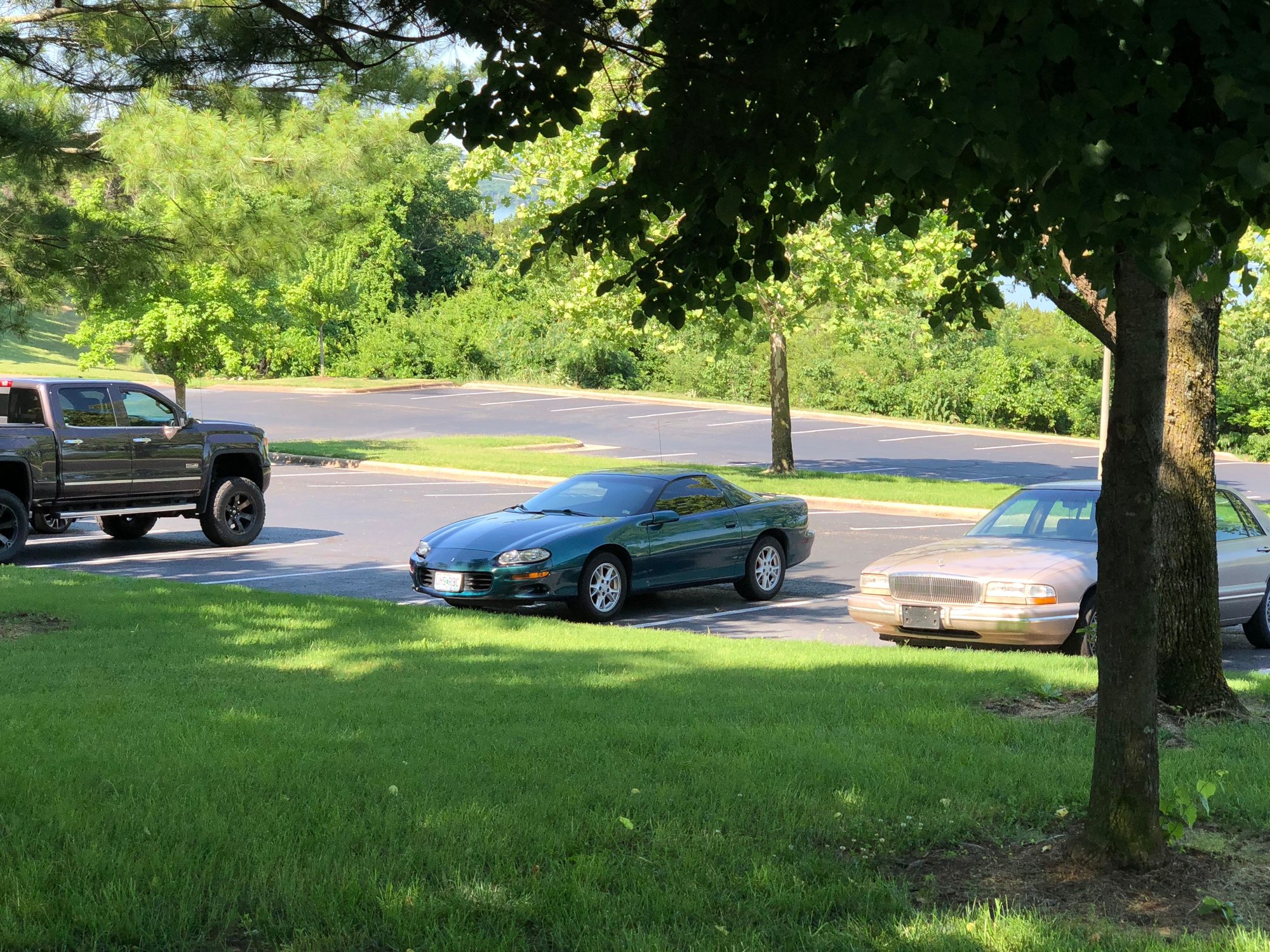

Hey guys I have a 2000 Chevrolet Camaro 3.8l, i've owner her for around 7 years now, she got me to point a to point b for over 80,000 miles. Recently however she has been sitting for 4 years, however I have been starting the car and driving it around for those 4 years. But for the past year and a half i keep having a stalling issue at idle that I cant seem to solve. It will stall at stop lights and stop signs. It will also stall when it idles in a parking spot for too long. I am not sure what to do at this point seeing how I have replaced the; Alternator, Plug wires, Plugs, Fuel pump, fuel injectors, fuel pressure regulator, fuel filter, air filter, MAF sensor, MAP sensor, and PVC valve. I have checked the fuel pressure and it is within specs, I have checked the fuel pump relay and fuses and they are all good, I have put seafoam fuel treatment in and added 93 octane fresh new gas to the tank and nothing has worked. Also no engine codes are showing up. If anyone has any ideas or information that can help I would be forever thankful, I just want to get her back up and running after sitting so long.
