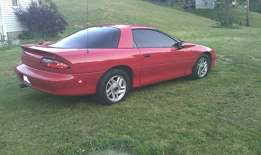

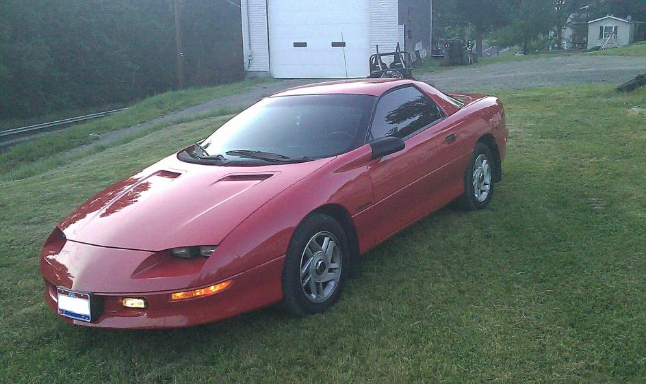

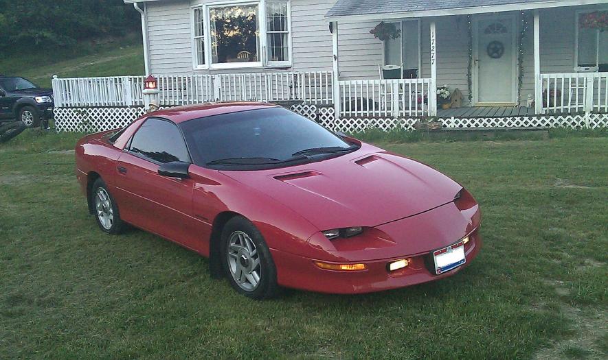

sorry guys the weather here has been so nice i havent had time to upload these pictures... But here's it's current state to show you guys a teenager can take care of his car.

Thats a good looking car.
