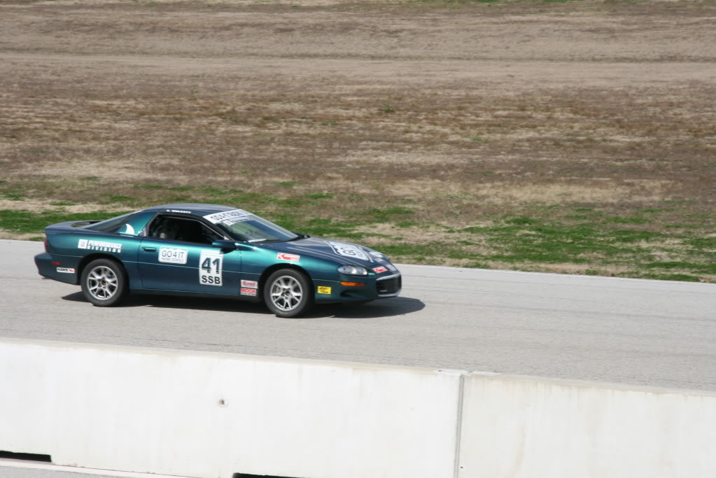

Haven't formally introduced myself yet, but i'm here to share that just recently back from an SCCA double national at MSR outside of Houston, the SSB lap record has been reset by me and my 2001 V6 Camaro.
My name is Travis, and i've had the car for a couple months to campaign in the Rocky Mountain division SCCA national club racing events. so far so good with two wins in the back by way of texas. here's the car.
