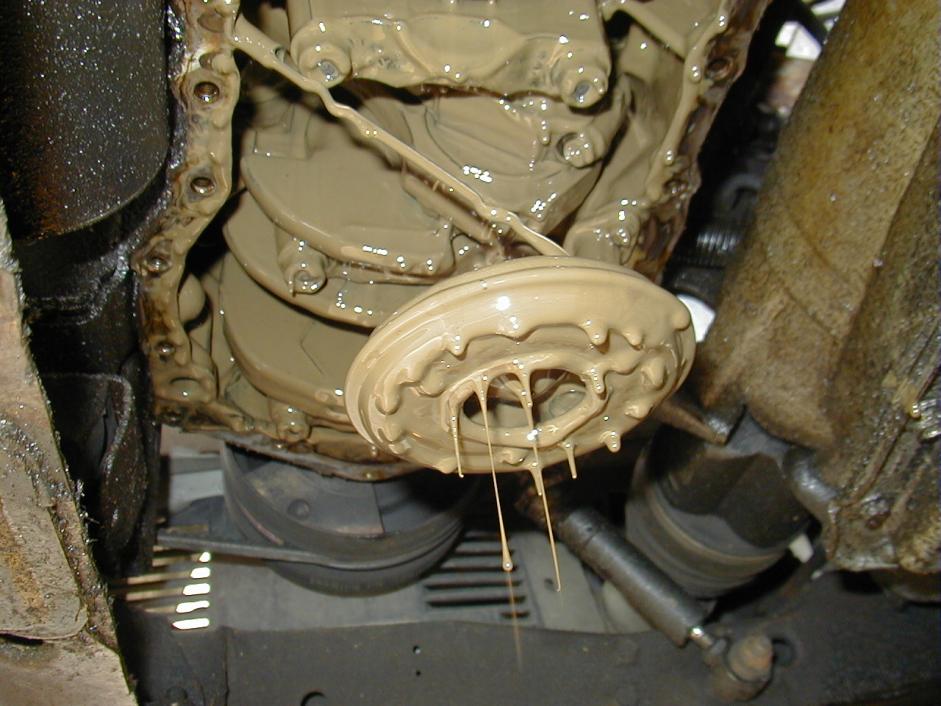

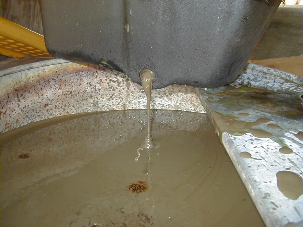

Oh, and here's an even nastier example from an 85 Oldsmobile I bought with a blown engine.
The camshaft walked forward into the timing cover and bored into the water pump cavity.
Coolant sprayed into the crankcase and the guy kept driving until the engine blew up. That's pretty hard to do to a 3.8.
This stuff was really, really, thick and nasty. The term milkshake was very appropriate, LOL.

That is perfect examples. Actually inside my oil cap is clean, it was only the tube itself. I couldn't get a picture of the oil that didn't have such a bad glare on it but it was normal looking oil, only a little darker than when you first put it in.
