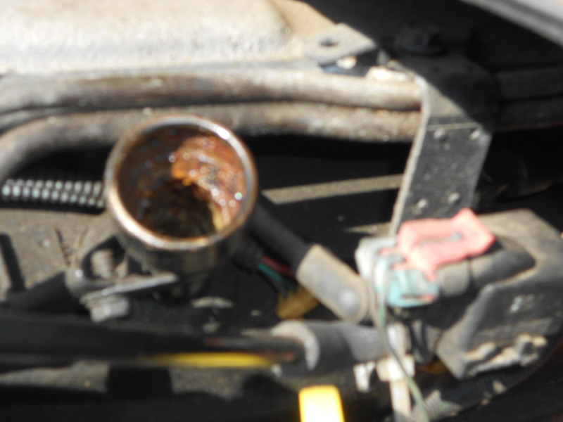

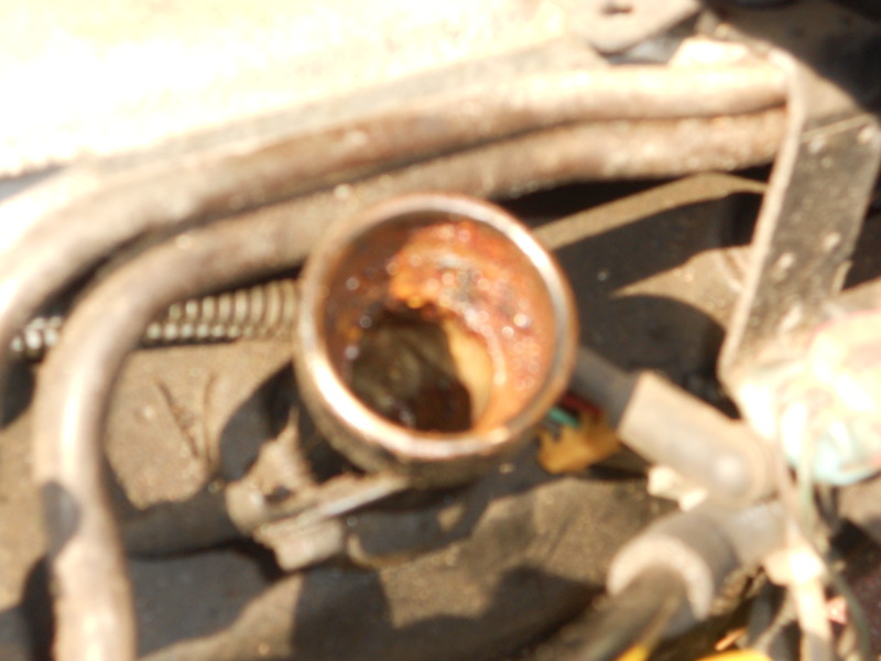

Now that the oil is out, you can see inside the cap. It's hard to get a good pic but you get the point.

"Now that the oil is out", what does that mean. Was the oil to the top of the fill tube?
And oh yeah.....yuck!

uh.. no the oil wasn't up to that far but I wiped out some oil so you can see the yellowish color in there. Is that what is referred to as "milkshake"??

That looks more like what comes out of the other end of a cow (not the udder end).
Milkshake is when coolant mixes with the oil, gets frothed up, and makes the oil look brownish in color.
What you have is a build up from oil vapors and moisture causing sludge and rust on the filler tube. When was the last time the cap was off, and what did it look like then?

It's always looked like that. Last time it was off was last oil change few months back. What can you do about that?
Old Sep 25, 2012 | 05:43 PM
Isn't this the same car that you're suspecting may have a head gasket problem? Do you do a lot of short run trips? Not driving long enough to burn off all the moisture can be one cause of what you have there. You shouldn't let it get to that point. And I'm sure when you're filling the engine with oil, you're dragging some of that slime down with it. If the engine is still ok, I'd carefully reach down the tube with a long threaded rod, trying not to knock any crud into the pan, then rake the junk up and out. Once the big chunks are gone, you can clean with a rag wrapped around the rod. Then do a final flush with a quart or two or three of oil down the tube, and out the drain plug.

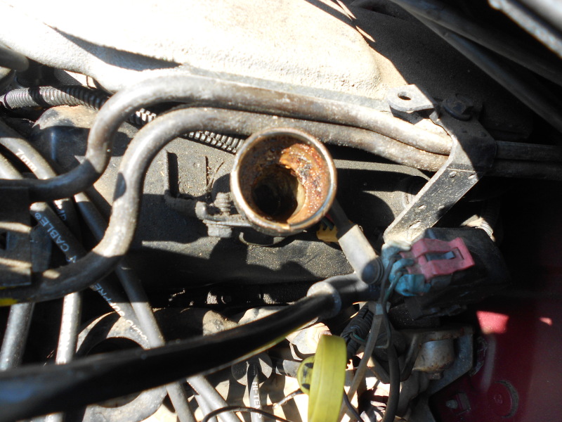

I had the same dark milky stuff around my oil cap the other day, got really worried it was a head gasket problem however after getting a block test done concluded there was no problem. I spoke to a couple of mechanics who both said its common on some cars for moisture to get in there if you don't drive a lot.
heres what mine looked like, i just clean it out occasionally: I must say it doesnt look as bad as yours does though...
Kind of hard to see here, but it goes down into the neck of the oil filler neck aswell:
