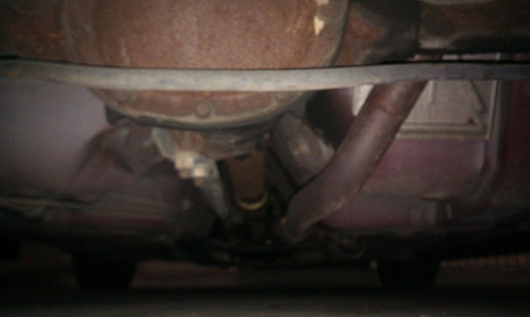

where and how would I do that on here? View is from the rear looking toward the front of my car.

ok to pinpoint the issue with the rear vibration bc that is my major concern. Could it be Runout? I only feel it at like 40mph or less and after having the tires rotated and balanced today (free deal at Discount tire for me), the vibrations still occur. should I still check the driveshaft Gorn? and where? I know that's a bad pic but I'm at work and I was trying my best to figure it before tomorrow morning. Cheap/ inexpensive way I can check for Runout if it is?
