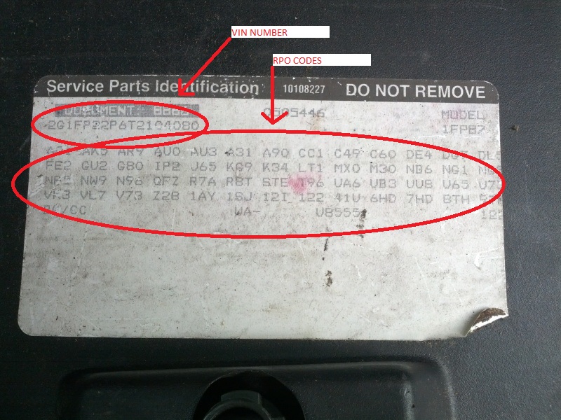

Congrats on the new toy!
Have you opened the glove box yet? You can check the "RPO" codes as there are lists posted online. If it is the glove box the car came with it will give you a break down of what the car came with from factory (Gears, interior package, motor package... etc). Also you can compare the vin number on the tag towards the top left to the vin of the car and it will tell if it is the stock glove box. This will not tell you everything about the car but it will tell you what she started her life as but A LOT CHANGES after changing hands after almost 20 years.
Here is a site I used to look mine up:
http://www.f-body.org/tech/4th_gen.htm#rpo
The VIN won't give you much info other than what you already know about the car.
This is a picture of mine
Mine as an example:
LT1 - Engine, 5.7L (V8) MFI
GU2 - Axle, Rear 2.73 Ratio
M30 - Transmission - Automatic, 4-Speed, 4LE, Electronic
Z28 - Merchandised Package - Special Performance
AND so on...
