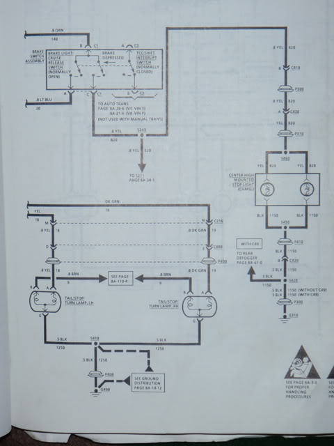

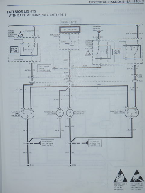

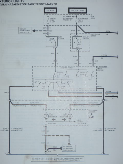

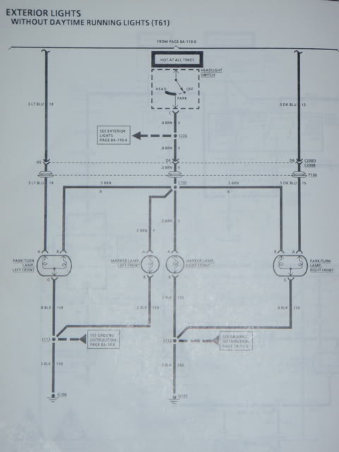

id say one of the bulbs is ready to go or has but the element has reconnected in a way that draws less amps. but thats a guess. lol. otherwise id say you have a lose ground or bad bulb socket
