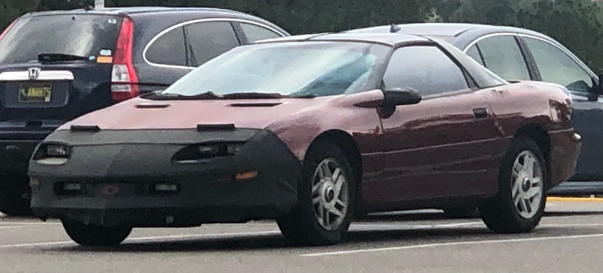

After many repairs my '94 no longer starts. My local autoshop tells me it's some electrical issue, wiring needs to be redone. I dunno. This was after they charged me out the *** to replace the ECM. They tell me they had it running and driving a day before I went to pick it up and it wouldn't start. They don't want to put anymore employee time into it and I couldn't afford it right now anyway. I figure I might try and fix it myself before I junkyard it but I'm no mechanic. I don't have a garage, hardly any tools, and no "know how" beyond changing bulbs and oil changes. I am 21 years old, this is my first car. I've driven it for the past 3 years and have fallen in love. I dunno what I'm gonna do.

Months ago the engine kicked out shortly after starting it and barely driving out of my drive way to go to an appointment. I then took it to the shop and after a month or two they said the ECM was the problem and they were waiting on getting one in to program but once they did they got it all working again. I go to go pick it up. No dice. Doesn't start. It's like I have the cursed touch. They fumble around with it for another week or so, say they got it working again and again I go to pick it up. This time it DOES start but it shuts off the moment I turn the wheel. They told me they were done with it and I towed it back home where it's sat ever since.
