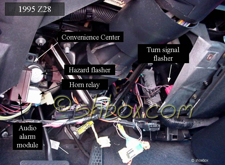

When I push the indicator stick either left or right, the lights come on and stay solid. They don't flash. What is likely cause?
Note with the hazards on they flash normally like they should. Have verified no bulbs are blown.
Note this is an export model - not sure if the lights are different to the USA 4th gens. It doesn't gave drls I don't think. Cheers.

This is an easy one. There are flasher controllers in the dash. There are separate ones for the blinkers and the hazard flasher. The controller modular for the flasher units has gone out. Replace it! There are you tube videos on how to do this.

Perfect - thanks. Can someone give me a part number please. Can be difficult to source pars here in new Zealand.

easy to get them mixed. heres pic from shbox
