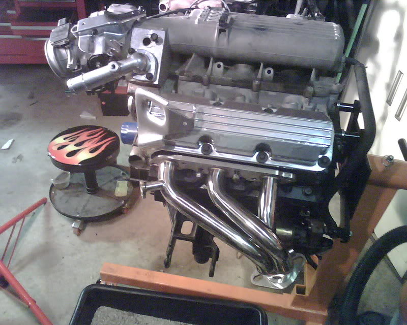

This is whats under my hood, Iz likes da shinny

As far as headers for the 3.8 OBX makes a great set of stainless shortys which I planned on ordering today.
That is what I have in my Car (pictured above) Are you installing them? There is a issue with the bolts not being anywhere near long enough to use the springs they supply correctly. I did this a couple of years ago but it took a few trips to the hardware store to get everything right in Stainless. That kind of stuff will really **** off your mechainc . They change to a nice gold color after you run them a bit. They are not the greatest Stainless as mine have some rust spotting on the underside but mine is a daily commuter that was doing 60-110 miles a day . Other then the spot rust they have been flawless for 2 years 40,000 miles
