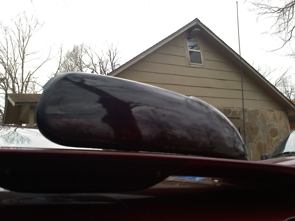

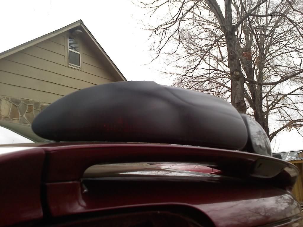

I had the opposite experience. I used VHT NightShades and mine turned out amazing. Here's a pic of them. The first pic is before I clear coated them and the second pic is after I cleared and buffed them. Also I had the clip ons at one point ad the VHT lets tons more light through from what I saw.

Also MaVeN: DO NOT tape stuff off to spray them. Take them out and do it the right way. Otherwise, you WILL get over spray. I don't care if you tape off the entire car, you will get over spray and you will not be very happy when you go to buff them out while they're in that small area in the front bumper.
