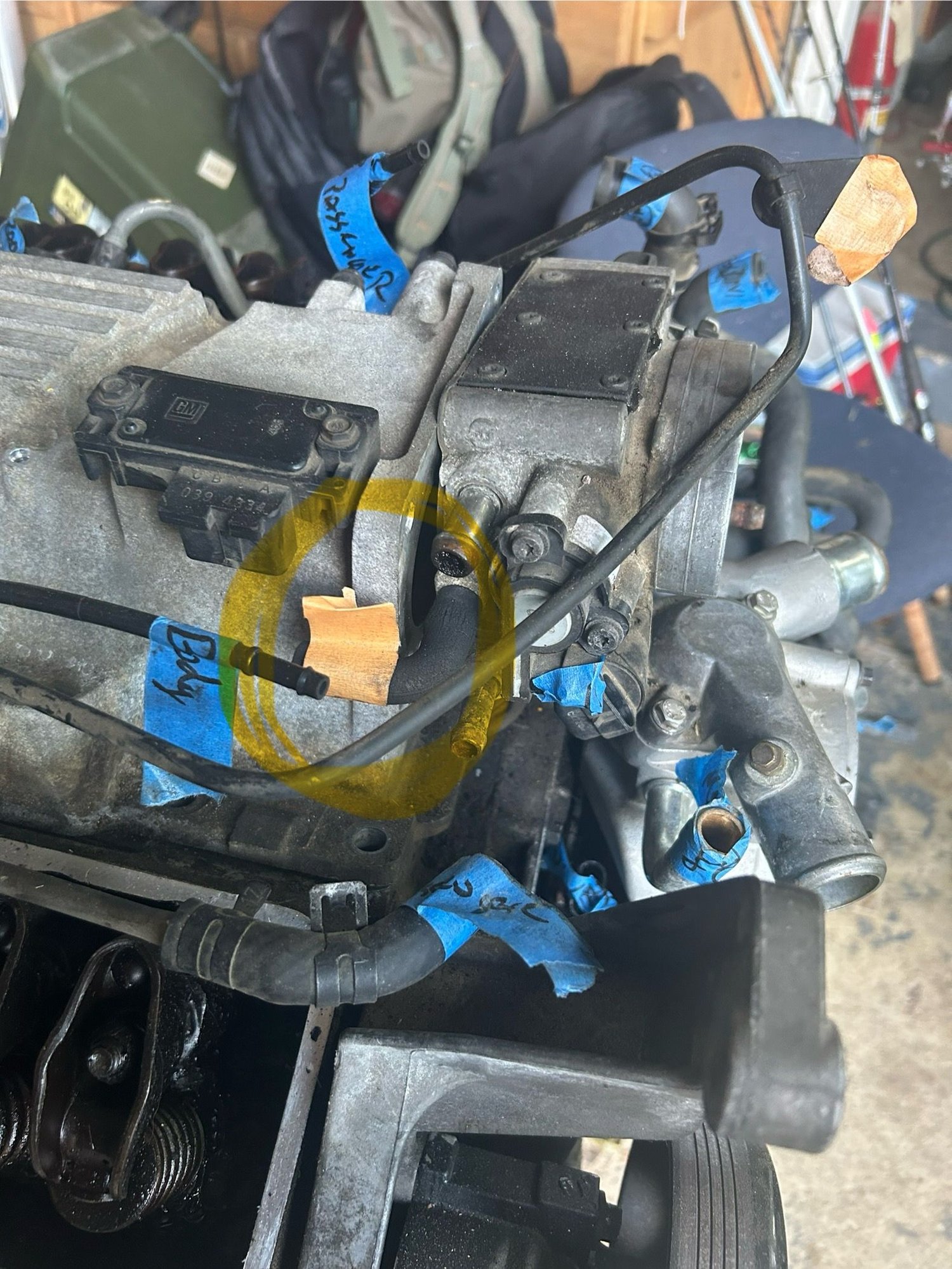

Can someone tell me what this hose (orange tape and circled) is or the part number? I need to replace. I'm sure its on web somewhere. On the passenger side throttle body.

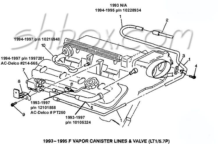

the black plastic pipe marked body should plug into it. evap vacuum, shows part number 10105324
