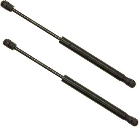

Hi, all, I have a trunk that keeps falling down, I usually prop it up w/ something like a baseball bat....oh hey.... don't get into a Road Rage or car jack incident w/ me LoL Jk
I don't want it to 1 day slam into the back of my head as the the plastic rod that usually holds it up, is slipping a lot lately--and it cramp;s my style when I go out with my next future wife
Hood Shocks?--back of my '93 Camaro trunk won't stay up.
1) Is this the part & '
2) easy to install?
thanks so very much for any help
pic attached

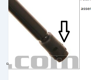

I just replaced the trunk supports on my 96, and it was super easy.
There is a little ring you pull back (see arrow) to release it, then pull it right off, don't forget to support the trunk lid properly first
And Rockauto have them, I would check the length thoroughly before placing the order as they come in different lengths
https://www.rockauto.com/en/catalog/...t+support,1404

agree with robroy and they will sorta go up by themselves too when new.
