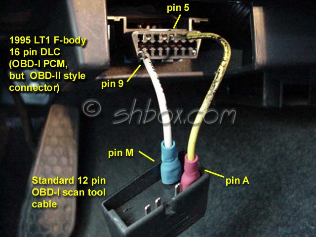

Adapt a 12 pin OBD-I scanner to your 1995 16 pin DLC
http://shbox.com/1/xraycable.jpg

The Actron CP9185 OBD1/OBD2 scanner already has a 16 pin cable/connector. No adapting is needed for a 95. The price is now $73, but it changes almost daily.
