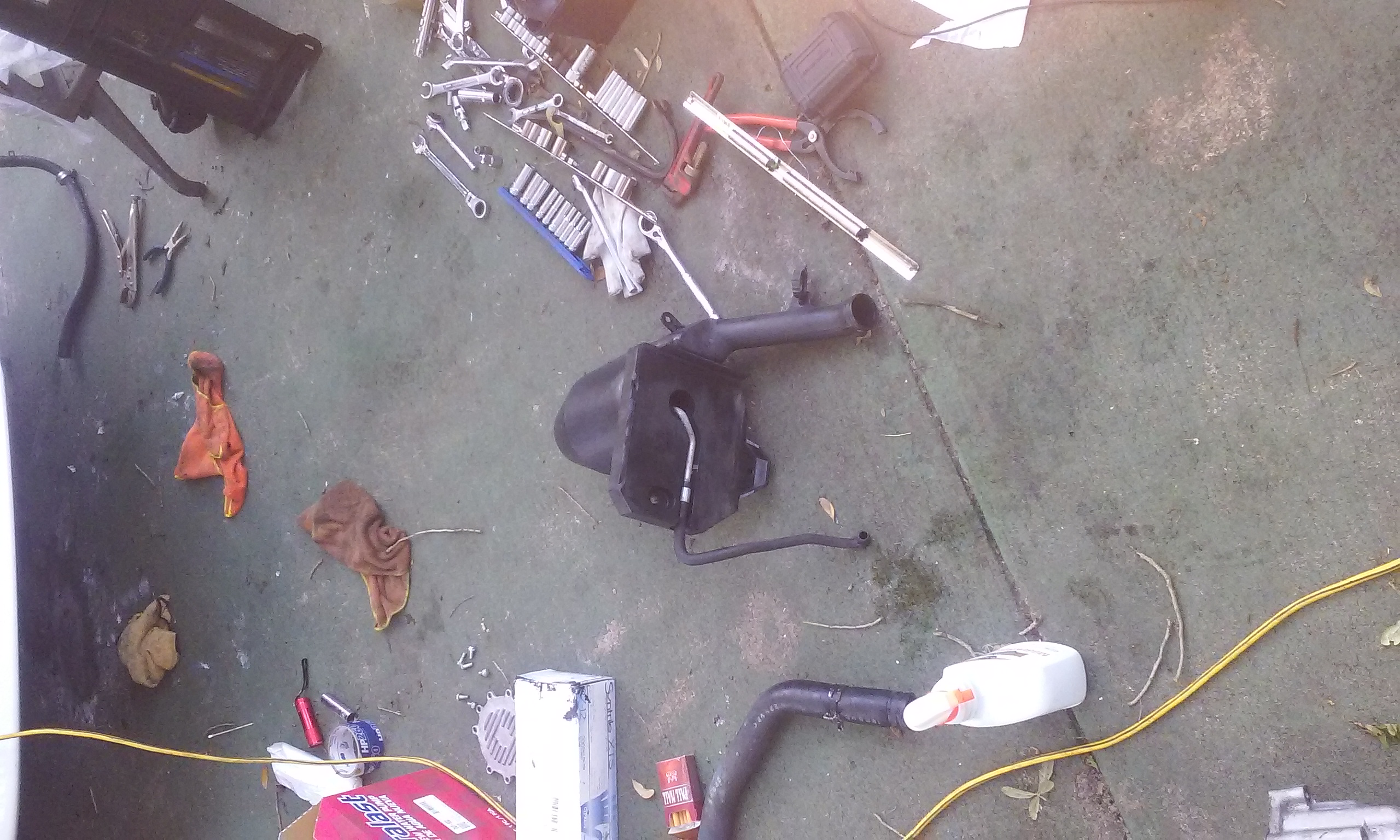

then i disconnected the reservoir and pulled it up out of the fender well and emptied it out. bright green then a blood red color after a few seconds of pouring. i thought, hm.. either someone mixed the red and green or thats rust/sediment in the water. well as it turns out the little metal hose that goes to the overflow underneath the battery was completely clogged. i tried to blow into the cap after it was emptied and figured air would come out the hose where it connects to the radiator but no dice.
so i removed the actual hose from the rest of the unit and got a metal coat hanger and tried to clear the blockage and was able to get some nasty dirty stuff to come out. took a few minutes of jamming it into the metal side before it cleared up.. so im guessing the blockage was right at the elbow on the metal section. a wire brush got most of the rust on the outside surface off and it looks good as new.

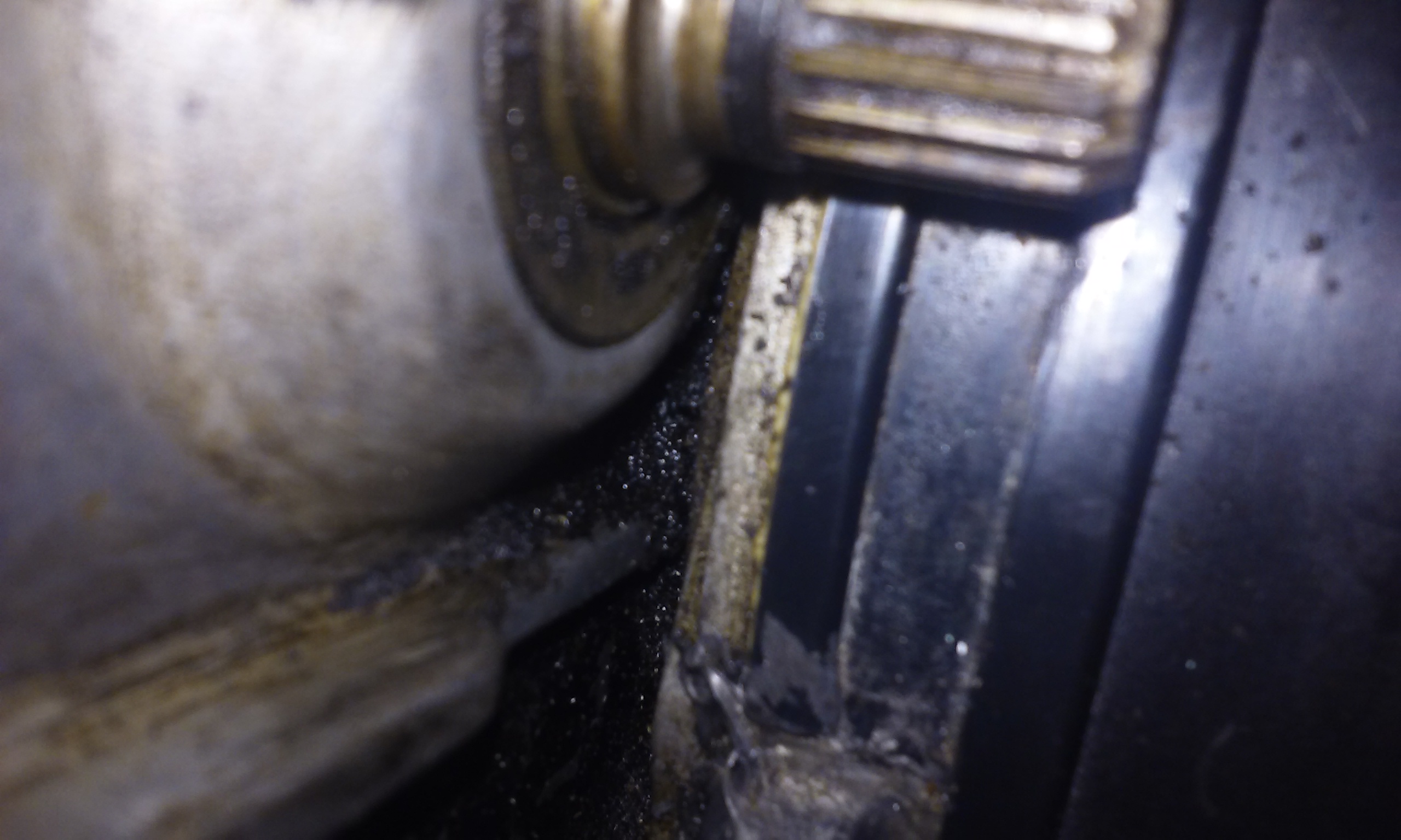

the timing cover was coated in oil pretty thick. maybe a leaking seal of some sort? got a few pics from after i cleaned up a bit. i took the pics so that i might be able to see what was down behind the opti without having to remove it and it was just grime.
