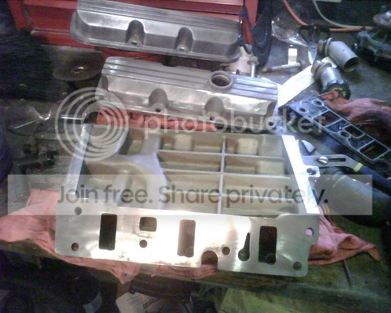

Intake is a pretty advance job for a beginner. How are you fixed for tools, do you have a torque wrench?
Hints:
Felpro gasket kit, get the metal elbows.
Parts can't be too clean, When prepping to install the new gasket everything needs to be clean, it is easy to say good enough, don't.
Hints:
Change the oil after you complete the gasket but before you start the car.
Thanks for the hint about the tools! I don't have anything special. My husband and I were just talking about torque wrenches yesterday. How'd you get your parts so clean? They look brand new!
I know I'm a beginner but I can do it! I just have to be patient and not go too fast and it'll get done. And also- thanks for the oils change step too. That's probably a good idea (plus it's due for a change soon anyway!)

Scotch brite pads, Mine is mounted on a power tool. Do not use brown or courser as they will take away the aluminum itself. They need to be clean to ensure sealing.
Just so you understand the reason for the oil change is because even though you have drained the coolant when you pull the intake off coolant will fall into your oil, this can destroy your motor if you start it.
The reason I asked about tools is because some of the bolts can be tuff to get at and a swivel ratchet or swivel sockets can help big time. I have about 35K in tools and I swear whenever I start a new project on a modern car there are tools I need.
