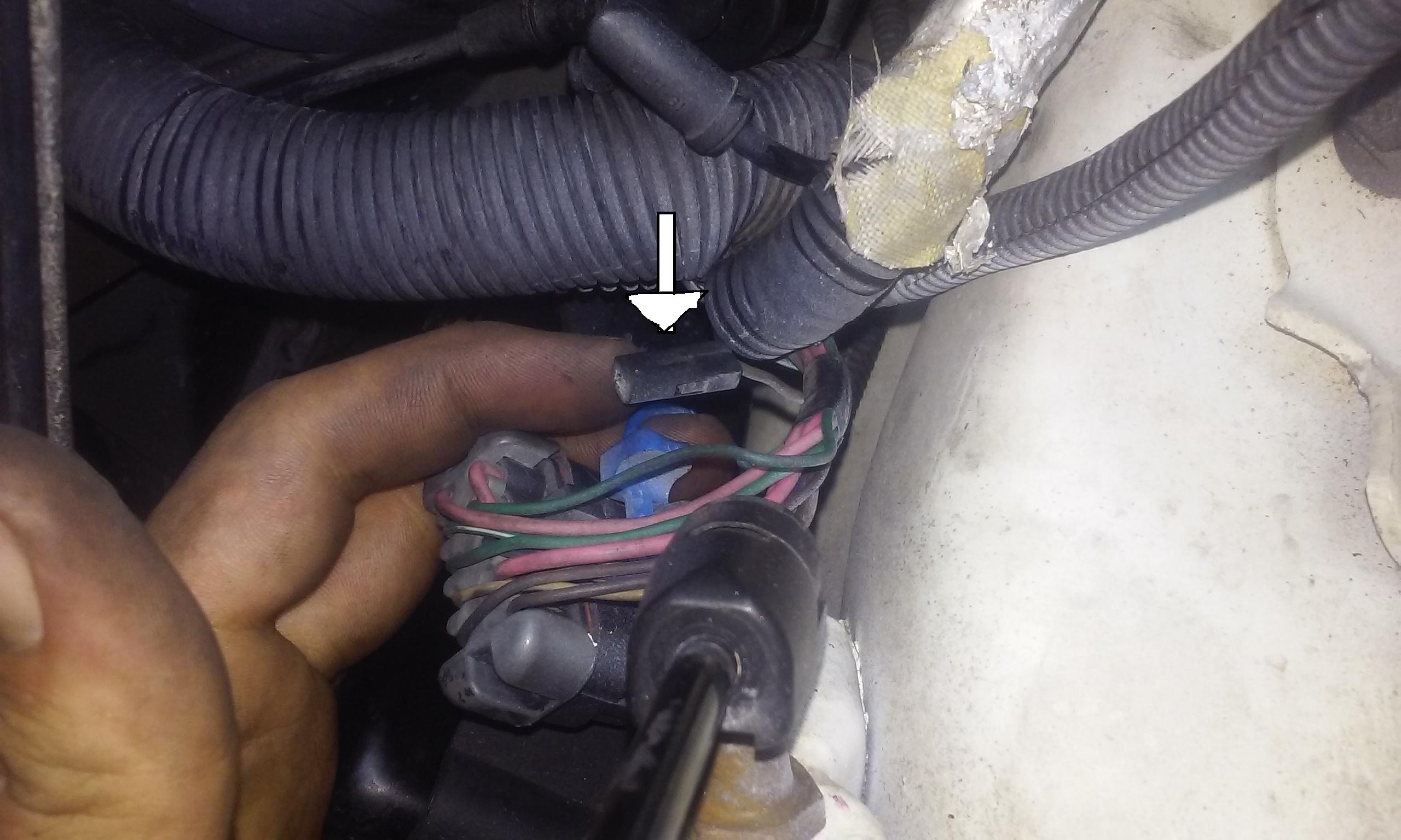

So I have two questions. One, check out these pictures. Can anyone tell me what this gray wire is? In the attachment, I have included a little arrow pointing to the wire Im talking about. Heres a link without the arrow for clarity.

I noticed it because Im trying to track down the reason why my coolant fans only engage when the AC is on, when the SES light is on, or when I engage diagnostic mode. I disconnected all the ground wires and cleaned then up the other day, I also replaced both coolant fan relays in the fuse box as well as the fan/act fuse. I was tracing the ground wires running from the battery and couldnt find any issue up to where the wire bundle meets the left side of the radiator but I didnt have time to go any further. My AC recently sprung a crippling leak and I have noticed that if the car remains idle too long my temps will slowly climb. I read that it could potentially be an issue with the ground's on the car but I have ruled out almost everything else it could possibly be and on my next day off I was going to really dig into the wiring and see if I could spot the issue.
Any comments/suggestions would be much appreciated.
Edit: Oh and for the record, I have tried two different fan shrouds and replaced the water pump coolant temperature sensor AND pigtail recently. Problem persists and Im stumped.

As far as the wire goes...hard to tell, but it looks like it's the A/C Evap temp sensor.
