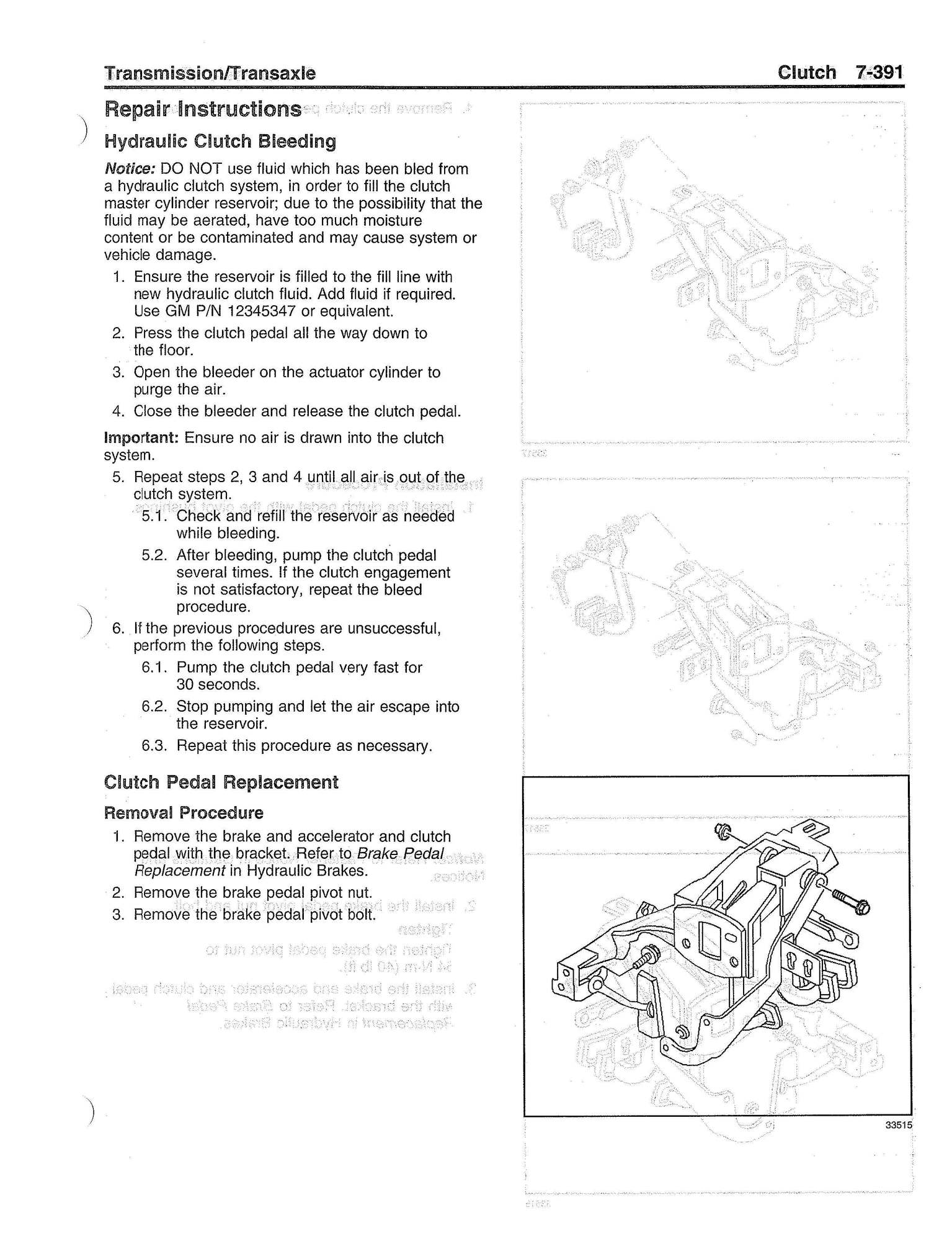

I'm assuming you're trying to bleed the clutch system, what I don't understand is what hose keeps popping off. Are you using something like a Mighty Vac pump to bleed with and the vac hose from the pump to the clutch master cylinder pops off? Otherwise, the hose going to the bearing from the master cylinder cannot have any leaks in the system to properly bleed and it has to withstand the hydraulic pressure from the master cylinder or it will have to be replaced. I've attached a page from the factory service manual that may help. You may want to pay attention to the instructions to pump the clutch pedal rapidly to force any air back up to the master cylinder.
