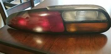

Hello, I need help on something I want to do.
I have a 95--the taillights for this model year don't have the amber turn signal section on them. I want to swap them out for the 98 taillights that have the amber turn signal. I attached pictures to show them.
Question is now, do I have my mechanic alter the wiring to tmake them work correctly or can the current wiring setup be used & just exchange out the taillights? Can anyone help?

Posts: 22,027
plug and play, should not require any altercations

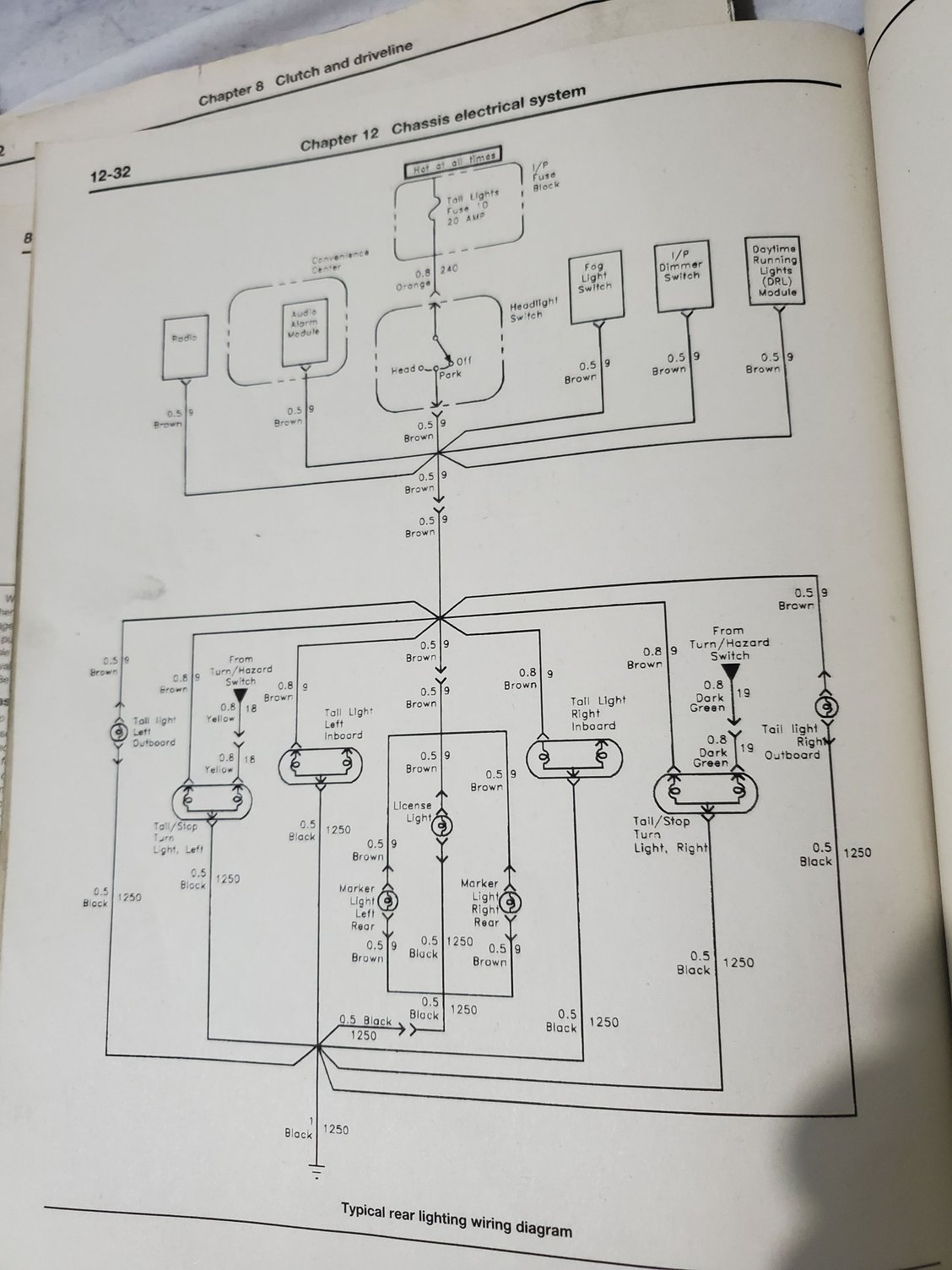

Actually, it is an issue to make them work correctly. I am trying figure it out. I bought the candy corns and i would also like to get the brake lights to work seperate from the turn signal. The original tail lights are only 2 colors. I have been reviewing the wire diagram from a chilton manual. I dont think its possible unless you install another wire.
Old Nov 13, 2021 | 08:08 AM
I put the amber tail lights on my old 96. Used the existing harness and sockets, but had to trim the slots in a couple of the socket openings in the housings with a utility knife, as the lock tabs have different clocking positions than the older housing does. NO need to rewire it.

From: homestead fl
I dont know what the original posters intent is. However i believe the amber lights are for turn signal ONLY. They come on when you turn on the switch at the dash. They should only blink when required. However on the original lights the blinker/brake lights are controlled by a single wire at the bulb socket.
Old Nov 13, 2021 | 08:37 AM
He wants to put the 97-up amber tail light housings on his 95. Works like a charm, just as I described.
