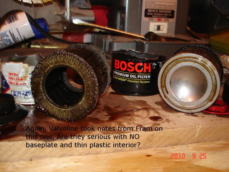

I've change the oil in my camaro every single time since I've owned the car. This past year, upon moving back home from college, I decided for the first time to save time and effort and filth by taking it into a Valvoline service center. They wanted to put 65 dollar premium high mileage synthetic in my 3800 series II. I laughed and said no. The charge still ended up being close to $50. It seemed worth it, as they finished everything up very quickly and I was clean.
Then I came home and noticed that they had stolen all of my quarters in my ash tray. Not even one quarter left behind to confuse me. I know they stole them.
I then waited 2400 miles, switch to Castrol high mileage with a Bosch premium filter. I will never go back to any Valvoline products ever again. Let's forget about their stealing habbits and focus on their RIDICULOUS $50 oil filter they are putting on vehicles. It's Fram-like. Anyone who has cut open a Fram knows what I'm talking about.

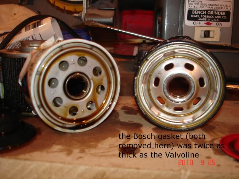

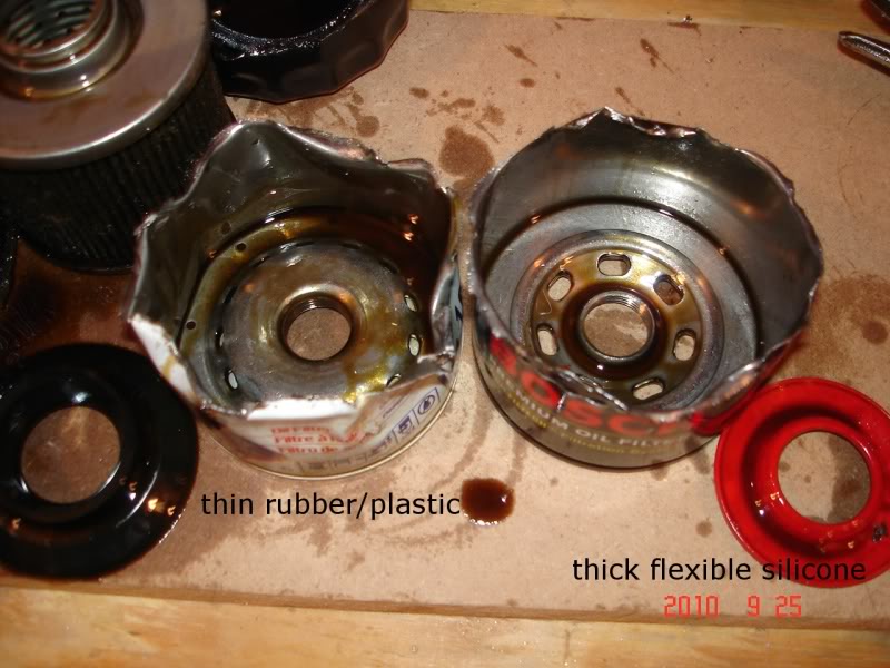

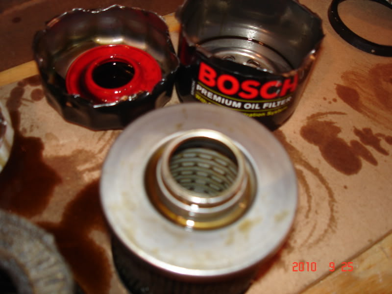

By cutting open the following two oil filters, I believe I am letting fellow oil-changers know the following: 1) Valvoline makes a cheap product, so how can you truly trust their oils. 2) No need to spend 12-15 on a premium oil filter. If you've been wondering how good Bosch filters are for their extremely reasonable price, let these photos convince you that you can save a lot of money (vs the K&N or Mobil filters) by using Bosch.
The photos speak for themselves. All you really need to see is that valvoline filters use thin black plastic straight off of a toy and paper plating along with a very brittle hard paper filter media. The Bosch uses metal supports, metal interior grating, an orange silicone material, and an engine block gasket TWICE as thick.
Still, I'm up for improvements. Anyone have any problems with Castrol high mileage oils? Should I be using a full synthetic at 86,000 miles?

Thanks guys. My lesson learned: follow what I've done for 8 years with the vehicle, which involves changing your own oil, and saving an *** load of money by purchasing your oil at walmart. Sorry Valvoline, I bet you didn't expect your customers to cut open your oil filters and check their quarter supply in their ash tray...

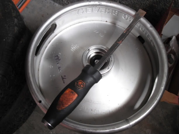

I used to work at a national chain used car dealer so for convenience I would get my oil changes done there while I was working. I assumed since I worked there and I knew the people, I wouldn't have problems. Wrong.
They changed the oil in the Camaro shortly after I got it. That was the first and last time my Camaro will go to a shop...
^ I leave work and get home, pop the hood to check my air filter, and see that they left me a "present" under the hood. Of course the tech who worked on it denied that it was his. But he was the only one who touched my car.. I was working in the bay right next to him. So I call this pry bar thingy the "LS1 killer". They're lucky it didn't cause damage.
