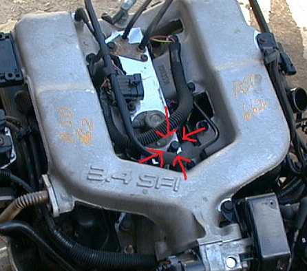

I bought my fuel pump from RockAuto for like $90 I think. Also you can check your fuel pressure by opening the valve on your fuel rail. It's right behind the y-shape on your upper intake manifold. Easy to find. It may have a cap on it. Get in there with a screwdriver of a key and push it like you would a valve stem on a tire to see if there's pressure. If not, you likely have a clogged fuel filter or a bad fuel pump.

This is the check valve on your fuel rail. Like I said before, it's like a valve stem on a tire. You can push in the middle of it to see if you have pressure. You can also rent a fuel pressure tester at your local Autozone or Oreillys for pretty cheap to see what kind of pressure you have, whether it's too much, not enough, or just right.
